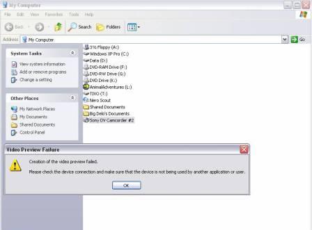

    Thanks Johnny. It did list a folder in My Computer. Below I inserted an image showing the "Sony DV Camcorder #2" & also the error I received. It said "Creation of the video preview failed" "Please check the device connection and make sure that the device is not being used by another application or user". Definitely sounds like youre on the right track. If its not too much trouble I would be interested in that software that logs stuff when connecting or disconnecting the camcorder. I just wanted to thank every1 for their help.

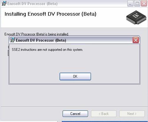

    Hi John. Thanks for taking all the time to type all those instructions. I really do appreciate it. I wasnt able to install the Enosoft software. Below I posted a screen shot of the error. Thanks for giving it a shot though.
    The software requires a CPU that supports the SSE2 instruction set.
    If you can wait a day or so, I can provide a version that will let you install it so you can try the various things I mentioned before. Please let me know.
    (The next scheduled release will permit installation and disable any features that require SSE2 when SSE2 isn't available.)
    EDIT - Re-reading this thread, I'm more convinced some software is hogging the MSDV driver that is needed for DV capture (you have two apps that complain AND Windows complains). Your screenshot showing the camcorder listed in My Computer also shows "Nero Scout". I did a quick google and came across this:
    http://digg.com/software/How_to_disable_Nero_Scout
    May be this is causing the problem? (Apparently it craps all over WIA - Windows scanner stuff).
    Anyway, what video editing software and tools do you have installed?
