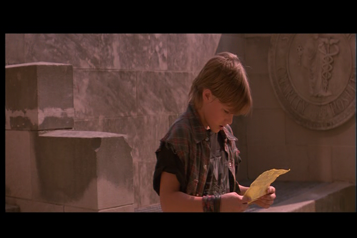

    Hi,
    Could you please advise whether the image (it is a movie) is interlaced or not? Here is a pic from VDM (zoomed 300%):
    If it is interlaced, how can I deinterlace it?
    Thank you!

    It sure looks interlaced.

  5. It's interlaced but from a 25 fps progressive source encoded with the fields out of phase. The AVISynth Telecide() filter can easily fix it.

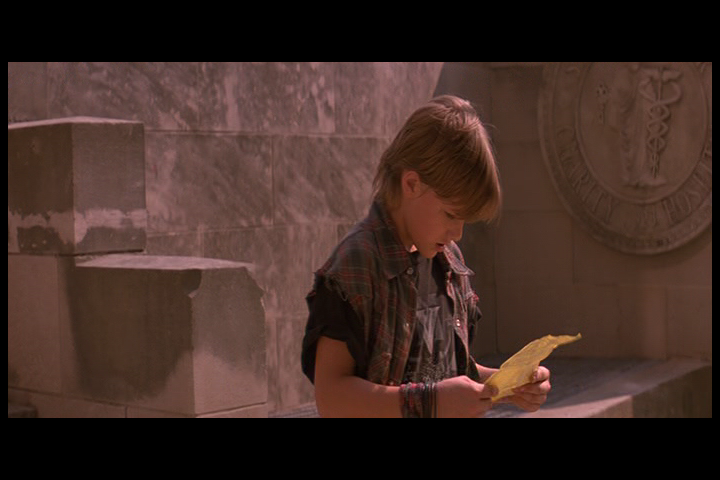

    Here is what my image looks like with my script:
    My script:
    My script with resizing but no cropping/addborders:
    See how the image from my script is centered?
    - John "FulciLives" Coleman
    P.S.
    Please note I kinda "screwed up" and didn't capture the exact same frame with both images although I think I am only a frame or two off.
