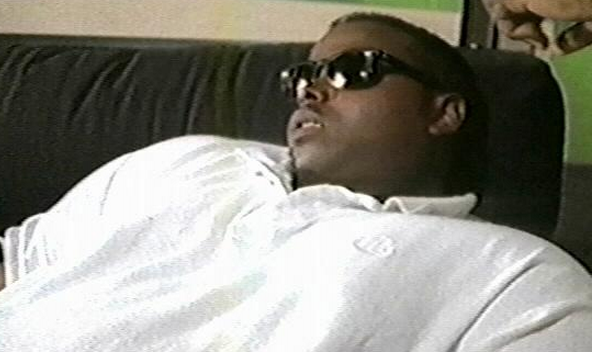

I have a MINOR discoloration problem in this project, and am hoping for advice.
I captured vhs using VirtualDubMod, using Huffyu to YUY2.
In a number of scenes, the sky has a definite green tint on the left hand one-third of the screen.
These occur mostly in sunrise/sunset scenes, and I speculate that it may have something to do with the sky being significantly brighter in that quadrant.
Also, all of the capture has a slightly darker discoloration in a stripe down the left side approx 20 pixels wide, and mostly not very obvious.
(ya, I know I probably need better equipment, wanna donate?)
But on these scenes, if I adjust the color to get the green out (using ColorMill and/or AviSynth Tweak and ColorYUV), that stripe stays pretty green and much more blatant because now it is in a contrasting color.
Is there any way to correct the green stripe short of “roto-scoping” and manually re-coloring the affected frames? I would rather not spend the next six weeks painting pixels, this film just ain’t that important to me.
Any advice will be gratefully accepted.

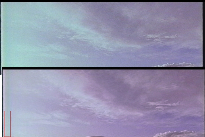

I'll post some before and afters shortly. Glad to see you got it working. Tough one, huh ?
comparison.avi -

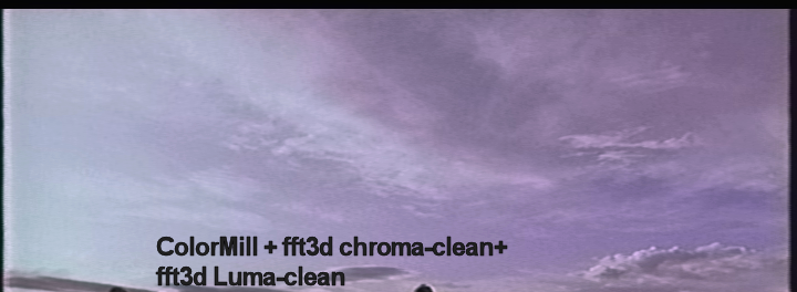

Try these settings:
mergechroma(last)
fft3dfilter(bt=4,sigma=19,plane=3,degrid=1)
fft3dfilter(bt=4,sigma=19,plane=2,degrid=1)
fft3dfilter(bt=4,sigma=19,plane=1,degrid=1)
mergeluma(last)
Soopafresh, I used your script with slightly stronger settings. It’s Deep Magic, ‘tis.
Too bad I can’t use FFT3d on my laundry.
The contrasting green is GONE.
A hint of a darker shadow-stripe remains, but no longer in a contrasting color. It’s almost un-noticable on (standard) tv playback.
I’ll have to twiddle ColorMill a bit more to compensate for too much red.
I’ve been playing with Trevlac’s TweakColor plugin because it works in YUY2 and YV12 , but doing color-correction without a gui needs the patience of the Sphinx.
Thanks again.Code:mergechroma(last) fft3dfilter(bt=4,sigma=25,plane=3,degrid=1) fft3dfilter(bt=4,sigma=20,plane=2,degrid=1) fft3dfilter(bt=4,sigma=20,plane=1,degrid=1) mergeluma(last) # # --- lightly clean luma to smooth some of the graininess fft3dfilter(sigma=1, plane=0) LoadVirtualdubplugin(vdPath+"colormill.vdf", "colormill",1) ConvertToRGB32() colormill(25710, 44388, 31069, 25699, 26212, 25708, 26468, \ 28516, 29028, 25700, 27260, 25701, 25700, 1124, 5)
