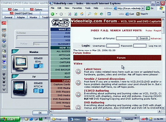

  6. Member edDV's Avatar
    Join Date: Mar 2004
    Location: Northern California, USA
    As an example of S-Video from a sharp source, this is a 800x600 desktop from an ATI 9550 display card over the S-Video output. The S-Video was then recaptured with a Canopus ADVC-100 and a frame was captured. Note the softened luminance and the loss of color crispness. Color bleeds due to the low resolution through the analog NTSC path.

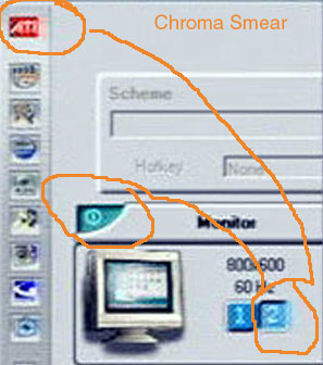

    We have extensively covered the 4:1:1 vs. 4:2:0 issues. If you are talking about analog 0.7Mhz S-Video, 4:1:1 and 4:2:0 are both way high resolution for chroma by comparison. Each S-Video "sample" or analog chroma equivalent "pixel" would overlay more than two 4:1:1 or 4:2:0 colors samples on a horizontal line (i.e. less than half horizontal chroma resolution). This results in a single chroma value being smeared over 8-12 luminance values over a line.
    Note here that the white letters have chroma smeared over them and that color overlaps the right edges.
    The 4:1:1 vs 4:2:0 issues are lost accross a horizontal line for S-Video but 4:1:1 has the advantage vertically since analog NTSC* still has 480 unique color samples vertically as does 4:1:1 DV. 4:2:0 samples blur across 3 vertical lines.

    Back in the day, when I was exploring this area, I found that this sort of
    business always yielded poor (reproduction of) the results of the signal.
    Oh, sure, you could make a few minor adjustments here and there, but it
    was not enough to reproduce the original video (that, which is on your pc)
    to the OUTPUT puts, like in your example demonstartion above.
    I know enough now, to not count on this type of scenario.
    (knowing this) I just find it unusual that someone would use such an example
    for an argument of proof of concept -- whatever.. you know what I mean.
    In other words, why didn't you just use an actual example scenario, at least
    according to the poster's playing ground -- he was refering to a dv cam and
    his s-video. Video OUT is a poor and inaccorate example to use. I don't
    think he was talking about an video OUT, you know.
    -vhelp 4139
    I agree that the ATI card S-Video out has other quality issues but the chroma smear issues track to camcorders. That is part of the NTSC encoding process. This is just the still I had to illustrate the issue. There are two issues degrading the S-Video path
    1. Chroma bandwidth compression as the U and V components get encoded to NTSC (or PAL) and then decoded.
    2. D/A followed by A/D in low quality capture cards. Both luminance and chroma are somehwhat degraded.
