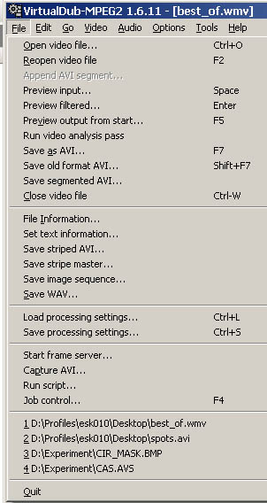

I use VirtualDub-MPEG2 to view my script.
1) Load script into VD-MPEG2
2) Make changes to script.
3) Save script.
4) Hit F2 in VD - script is reloaded and your changes are now viewable.

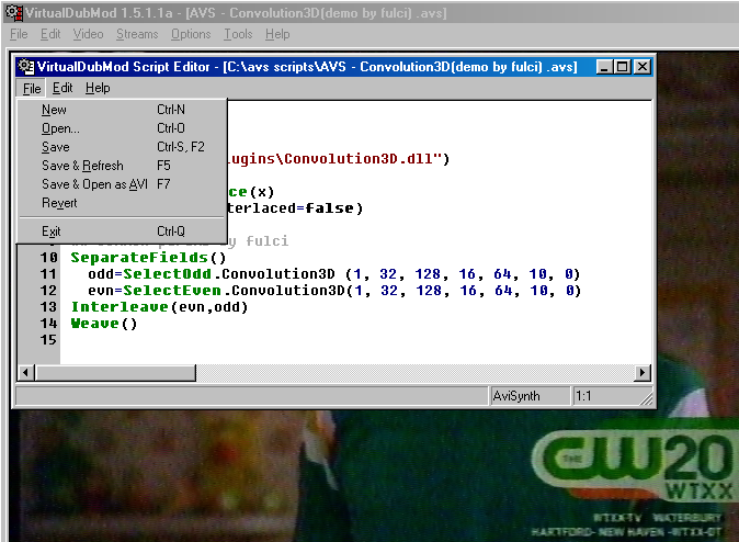

SLK001 wrote:
Using v1.5.1.1a here.. its the F5 key. Maybe you ment it too.4) Hit F2 in VD - script is reloaded and your changes are now viewable.
Been aken to give AvP a try, but its a .NET tool. Oh well.. I got rid of
a long time ago. Foowee on .NET
But I thought that someone created a front-end DLL that others could hook
into and create plugins just for this -- WYSIWYG -- maybe on doom9 or
some place else, perhaps.

Originally Posted by vhelp
No, in the later version 1.6.11 (not sure if it is the latest), it's F2.

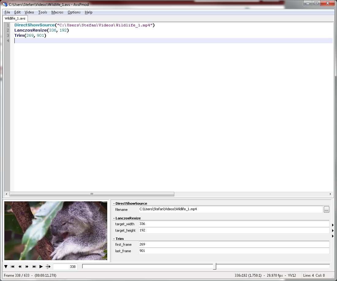

Sorry to kind of resurect this thread, but in Avsp, how do you get the slider bar to show up so that you can adjust the parameters when using certain filters.
ie. Tweak()
like in this screenshot
https://www.videohelp.com/toolsimages/avsp_957.jpg
EDIT: Aaah forget it. Figured it out.
For anyone else intrested, Find out how here. You gotta set them up yourself
http://www.avisynth.org/qwerpoi/UserSliders.html -

You don't need to copy/paste anything to get user sliders with newer versions of AVSP (e.g. 2.0). You only need to set initial values of the parameters you plan to adjust. Once you move the time slider, a set of filter names appears to the right from picture preview. Clicking a filter name makes sliders shown for the parameters typed for that filter (be it internal filter or external plugin). After changing slider position the values change in the script and can be saved with the script. When you open the script next time, the sliders are still there.Originally Posted by Hittz
LOLOLOLOLOLOLO I laugh at myself
And all the time I've been writing extrrrrrrra text. Like this?
Tweak(0.0,1.0,8,1.0)
I tried it and, BOOM the sliders came right up. Thank you Alex_Ander for your help. There is a lot of talent here on VideoHelp.com
