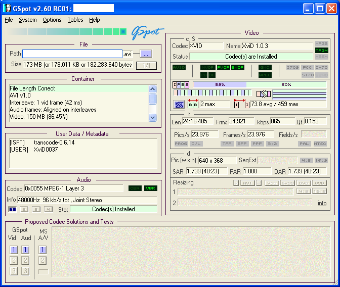

Download Gspot 2.60 and drop one of the problem files in there. You are looking to see if the green VBR audio indicator lights up. If so, that may be your sync problem. If not, you can at least see more info about the videos.

If no VBR, then you might want to post a screenshot of the Gspot page from the video. Blank out the video name.

Ran GSpot, neccessary Codecs were found, and the GREEN VBR indicator is positive. (I could only find one VBR indicator in the GSpot window... in the audio panel.) I'm familiar with Audacity and will now switch from VirtualDub to VDubMod. (I haven't been able to figure out batch/automate function)

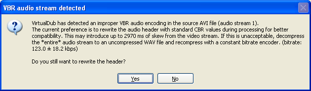

That's just your confirmation that you have VBR audio. Just click 'No' and go ahead and save it out as a WAV. The last part of that warning is what you will be doing by saving out as a WAV. You can put it back in and re-encode it to MP3 CBR also, but if you plan on encoding to MPEG, not really worth the extra work.
Most MPEG encoders will choke on MP3 VBR audio. They can't read the length properly, I suspect, and they mess up the encode. If you are getting Xvids or Divx files off the net, you will run into this problem fairly often.
It's not the only cause of bad sync when encoding, but by far the most common. Other causes are bad joining of video files from parts, or corrupted video/audio. BTW, WAV files are big. You may want to delete the WAVs after a successful encode. -

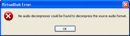

I went and executed a batch process for wav extraction from the AVIs in VDubMod. (So happy to be able to automate) One problem came up; of the 24 files, only 17 of them extracted properly. Here's the error code VDubMod spit out:
Those same "problem-videos" won't play back any sound in Vdub but play just fine with AV sync'd in WMP10. Each preceding screenshot relates to one specific file.
