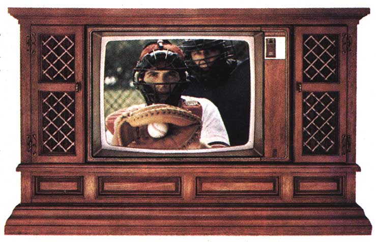

    Well I admit I have a soft spot in me for the old CONSOLE type televisions like the one in this picture:
    I grew up with a TV that was kinda like that

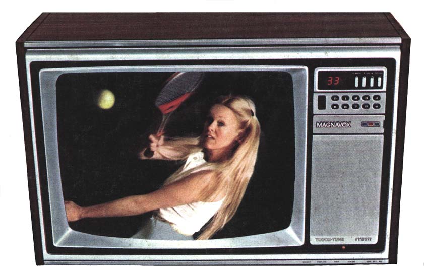

    Well I also remember having a TV like this one:
    Enough metal for you there?
    Although it does have that "fake" wood on the top and sides

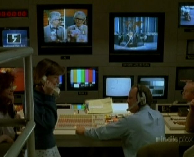

    More like this one ... metal and heavy

    Unless you grew up in a TV studio that's no fun LOL :P
