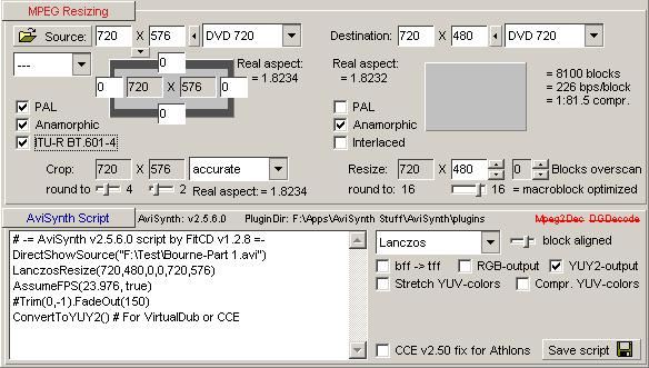

I am confused about FitToDisc script to convert PAL DVD into NTSC DVD.
I load d2v (PAL DVD) to FitToDisc. It shows PAL on the left side (Source). Do I undersdtand right that I should NOT check PAL on the right side if I need a script to convert into NTSC DVD?
It is confusing because I still set PAL in Procoder while encoding the file. Thanks.

Yes, in fit2Disc/FitCD you DO NOT tick PAL for output if your eventual target is NTSC
You encode NTSC resolution with a PAL framerate as the first step to achieving NTSC playback framerates using DGPulldown to go from 25 fps to 29.97 fps.Read my blog here.
You are better off using the DGPulldown method. I'm not sure how you would set up Procoder to do this as I don't use Procoder but basically you resize from PAL to NTSC but leave the FPS at 25fps.
After you get your video file you run it through DGPulldown and select the "25fps ---> 29.970fps" option. DGPulldown only takes a few minutes to spit out a new file that is now NTSC compliant and matches the length of the original audio file (which may need the delay value to be adjusted ... or not).

I cannot get why one script from FitToDisc is OK while another one is not OK though both have a good picture and play OK both on PC and my standalone. That's why I asked FulciLives in another post how he got those numbers in the script and why only those numbers would be correct.
May be this example would help me to understand? Could you please have a look at the original PAL DVD that I am about to convert to NTSC DVD, please?
I've got two scripts from FitToDisc:
LanczosResize(720,352,0,76,720,422)
AddBorders(0,64,0,64)
AssumeFPS(23.976, true)
Anamorphic:
LanczosResize(720,480,0,77,720,422)
Which one is correct?

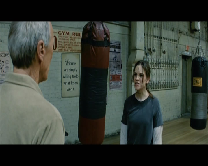

4.) See how much of the original black you need to chop off so that just the IMAGE is left. Sometimes it is none ... sometimes it is alot.
Now in your example I took a look at the image and you would have to cut 76 from the top and 76 from the bottom to completely remove the black.
What does that leave you with? It leaves you with a height of not 576 but 424.

That would be "good enough" in this case. But when re-encoding you want to eliminate any BLACK VIDEO BORDERS and add FRESH BLACK back.Code:LoadPlugin("C:\DVDSTUFF\DGMPGDec\DGDecode.dll") MPEG2Source("L:\DVDRIP\VIDEO_TS\movie.d2v") LanczosResize(720,480)
So load the video into VirtualDubMod using that script and now use the NULL TRANSFORM/CROPPING option to see how much black you need to cut.
In this example (based on your pic) you will find that you will need to cut 62 from the top and 62 from the bottom. In fact to be "safe" I would cut 64 from the top and bottom.

I don't know. I don't have any trouble using it for the PAL2NTSC DVD resize. You can do that Crop/AddBorders thing as FulciLives advises, but basically you just do a straight NTSC resize:
Note that LanczosResize(720,480,0,0,720,576) is the same as LanczosResize(720,480). No cropping is done. And if you're going the DGPulldown route, leave off the AssumeFPS(23.976) line. And why can't you get an NTSC copy of Million Dollar Baby where you live? Never mind. Don't answer that. -
