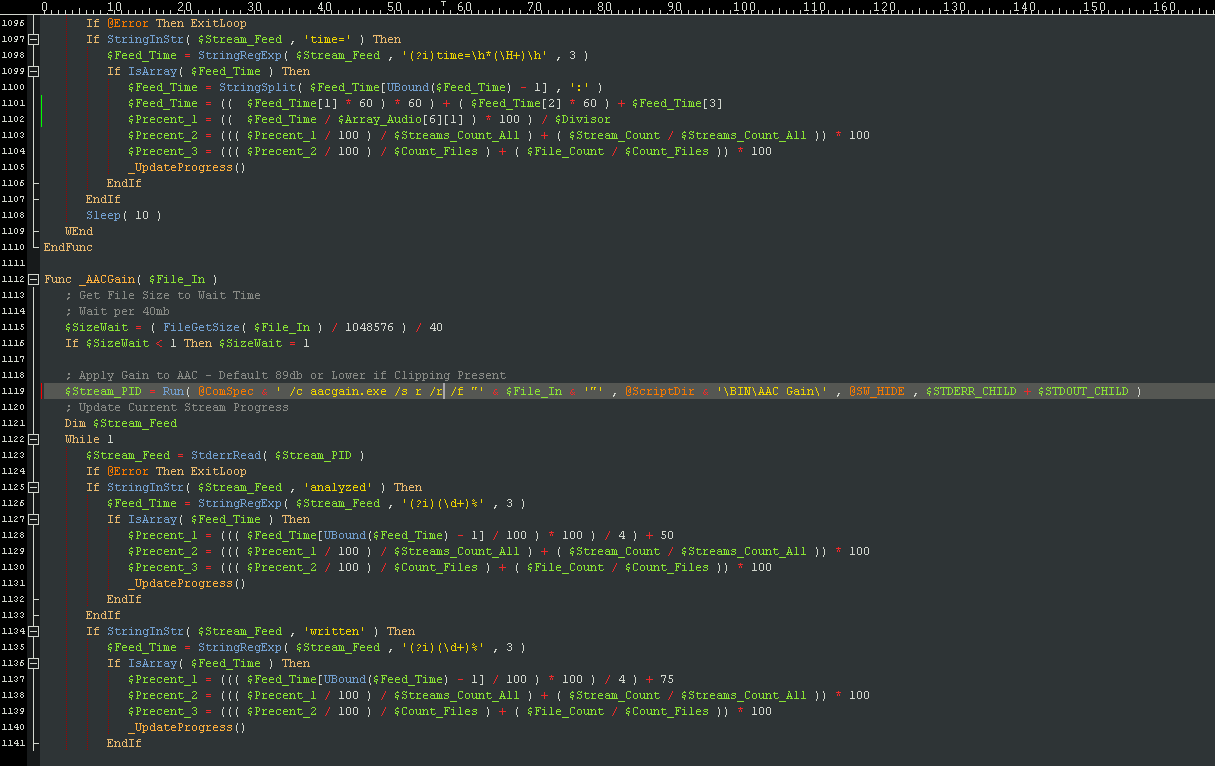

    This may be nothing but I did notice in the aacgain parameters you have "r" and "/r".
    I also took a look round for aacgain command line parameters but seemed to lead me back to mp3gains parameters.
    What it says for mp3gain is -c = ignore clipping and I also noticed you could add -d with a number to increase the default gain (i.e. -d 2.0 would increase the gain to 91.0)
    M.

    Just to be clear this is the command line:
    aacgain.exe /s r /r /k /f "'<file>'"
    Break down is as follows:
    /s r
    -- force re-calculation (do not read tag info)
    /r
    -- apply Track gain automatically (all files set to equal loudness)
    /k
    -- automatically lower Track/Album gain to not clip audio
    /f
    -- Assume input file is an MPEG 2 Layer III file
    -- (i.e. don't check for mis-named Layer I or Layer II files)
    -- This option is ignored for AAC files.
    The ReadMe for AACGain can be found in:
    .\Bin\_ReadMe's\
    Now compiles should actually be done for 32bit since there is data piping going on in the script...and half the stuff I use doesn't have a 64bit build. AACGain being one of those...plus out side of video encoding there isn't much of a difference in speed between the x86 & x64.
    I'm attaching an image of what it should look like...I doubt you did anything wrong...but just encase; I'll also put up a compile without the /k switch...but it honestly shouldn't make a diff who compiles the script.

    Anyways yeah you could also add in those other prams
    aacgain.exe /s r /r /c /d 2 /a /f "'<file>'"
    Hell even toss in /a for album gain as well. Shouldn't make a diff...but what the hell.

    I clear both popup boxes and on checking memory usage now VideoGainMP3.exe is is 1,351,792, cpu
    usage is 25%
    TESTS ON XP
    Am running VideoGain (re-compiled unaltered 1.4) on an XP machine and seems to be working, memory
    usage is 16,748 (is now encoding audio with ffmpeg) - that finished successfully in around 28mins.
    I then removed the /k from the source, recompiled and ran it on the same file, been out for two
    hours, came back and it is still running, 3/4 of the way through "Normalize Audio Stream".
    No errors as yet.
    VideoGain is running at between 42 and 52 CPU usage, memory usage is moving up and down, currently
    25,320.
    aacgain is running at between 35 and 46 CPU usage, memory usage = 4392 and is static.
    I do have other stuff running on this machine which might be memory intensive plus its low spec
    AMD FX60, 2Gb RAM
    This continued for a further hour with no visible progress, still changing cpu and memory usage
    so theoretically still running but after 3hrs doubt it would finish. Decided to just kill the
    accgain process, is now continuing "merging streams".
    Has now completed but output file is approx (almost exactly actually, 50% of original size)
    SUMMARY
    On Win7
    1.4 as supplied (with /k) works.
    Recompile here with /k removed does not work "Error Allocating Memory"
    "VideoGain Mp3 No K" as downloaded above gives same error as above "Error Allocating Memory"
    On XP
    1.4 as supplied AND compiled locally works
    Recompile here with /k removed hangs in the same place as above but never crashes with error.
    Seems to be aacgain that 'hangs', when killed off program completes.
    Fairly stuck now, for some reason just removing the /k for aacgain causes problems?? I am
    now running the script (uncompiled) on the XP machine in case this gives any further clues but
    I suspect it wont.
    M.

    UPDATE ON XP TEST
    This is running the script with the /k removed, program crashes at 3/4 of the way through Normalize audio (as before) wirh the AutoIt error "Error Allocating Memory".
    Have done these tests on 2 separate AVIs but wonder if it's something to do with either clipping at a certain point or filesize, going to try on a completely different AVI file.
    M.

    OK, tried using a smaller file with less dynamics sound wise (TV file)
    I ran it on XP & Win7, using the new executables BOTH crashed in exactly the same place, approx 3/4 of the way through. I even overlayed the images and it's EXACT, The files were 880Mb and 245Mb so it's not file related.
    M.

    Drop in MP3Gain and edit the script accordingly and see if things go away.
    Dang just noticed I didn't read all of your posts...need more coffee.
    Yeah that is surprising that the /k switch would cause that...as it shouldn't but maybe with MP3Gain there won't be the issue.
    hmm actually you brought up using /c to ignore clip warnings...maybe toss that in and see if that helps.
    Oh and many thanks for the detailed testing.
