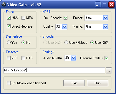

    New Version 1.32
    Updated:
    - FFMpeg
    - x264
    - MKVToolsNix
    - Sox
    New Features:
    - Auto Deinterlace VOB files
    - Deinterlace toggle
    - Select Video Encoder Application
    - Added File Extensions DivX, VOB
    - Auto Clearing of ReadOnly & Archive Flags on Video's to be Replaced
    - Tally of Bytes saved from Re-Encoding Files
    Fixed:
    - Kill Process HotKey Function, Now Properly Closes Child Processes & Empties Temp Folder
    - Removing External Subtitles for Video Replace

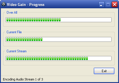

    Oh something that might be making it into the next version:
    Might make it easier telling where things are in a batch.
