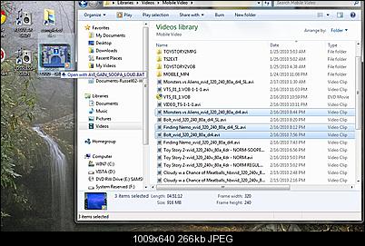

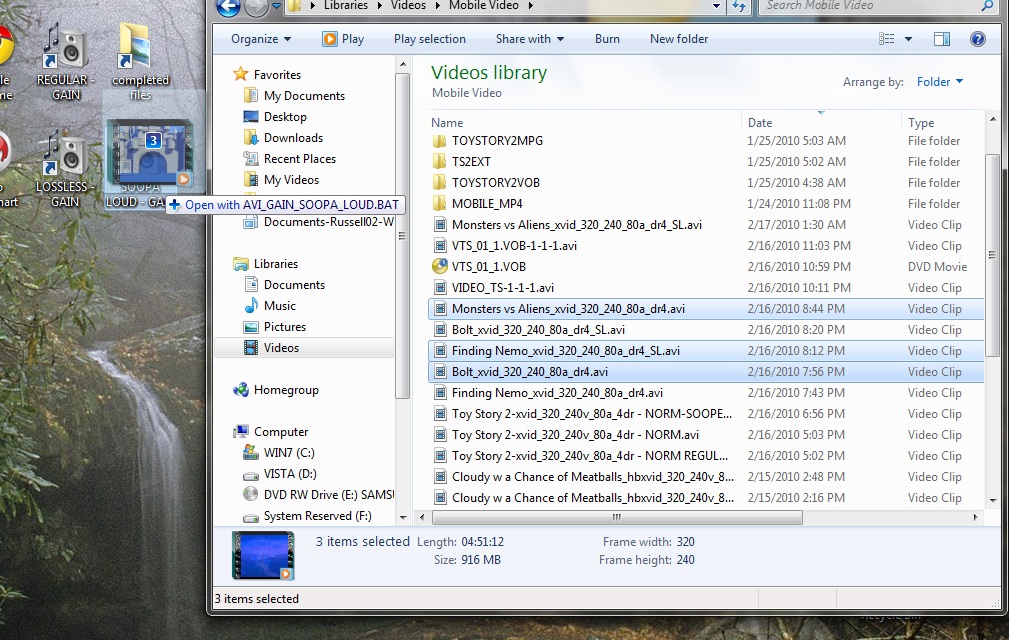

    In my use of your util, I found a way to improve it a bit (and let us be a little more lazy). I've been using computers since I was 5 (no joke) and am 32 now - and am very familiar with batch coding from when I was younger and in my day-to-day job as an IT Admin. I modified your script to allow for multiple-file drag-and-drop capability - as I saw where you posted a note to 'not drop files onto the batch shortcut'. Took a lot of tinkering around since I'd never done this - but had seen it done on several utils I had used in the past. I finally got this working beautifully and have tested it with multiple files.
    So basically, it lets you CTRL-CLICK, SHIFT-CLICK, or drag and select (or etc.) two, three or MANY files - and drag-and-drop those onto a shortcut to your script on the desktop and converts - making it fairly close to a GUI experience (but without input capability). It took some major re-working of the variables in there to get it to work - plus I cleaned up a little of the code and made it not so 'redundant' (by making the 'for' statement one nested set instead of repeating it on each line). I left most of your regular items in-tact including your 'soopa' and 'v1deo' 'catch-phrases' if you will.
    I've posted a screenshot so you can see how it works.
    Let me know if you're interested and I'll upload it for you to include with your set. All I would ask is for maybe a small shameless mention of credit - as I appreciate your script which has made my job of converting videos for the kiddos MUCH easier and straight-forward now.

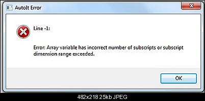

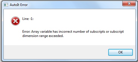

    Nologic, I did try the GUI, but I could never really get it to work. I always get this error, no matter what settings I choose:

    Okay I've updated my app...not the big rewrite I had planned...been a little bit more busy than expected.
    The Array Error that sincostan45 and others have ran into "should" be resolved.
