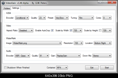

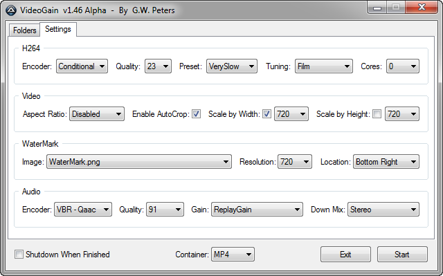

    Okay new version...I'm labeling it Alpha for 2 reasons, #1 not as much testing as I would have liked, #2 it's feature incomplete for what I wanted to release.
    Audio Encoding with FDK will fail...mostly because the build of FFMpeg that I package is not compiled with that option. There is a standalone encoder for it...but you have to compile it as well...and well I'm a bit limited on time presently...hence why there isn't as much testing as I would like done.
    Note:
    Please delete your original VideoGain.ini as the format has changed a bit.
    ChangeLog
    Added Alternate Destination Path
    Added support for Multiple Primary Folders
    Added Drag & Drop support for adding folders
    Added limiting CPU Cores with FFMpeg
    Added Aspect Ration Correction
    Added AutoCrop
    Added Scale by Width
    Added Scale by Height
    Added back Multiple Video Encoders
    Added Multiple Audio Encoders
    Added support for Multiple Gain Types
    Added Audio Channel DownMixing
    Updated FFMpeg
    Updated MKVToolNix
    Updated Subtitle Workshop
Name:	VideoGain v1.46 Alpha.png
