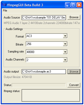

4.) Go to the folder with the ffmpegGUI files. Double click on ffmpeggui.exe to open up the program.
5.) Now set it up as follows:
Do that and then click on CONVERT and it will create an AC-3 audio file for you.

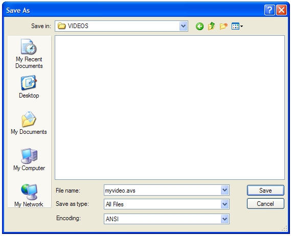

Now we need to save this script. Be careful when you save it to not save it with a TXT at the end. Do it like this:
Notice that I put ".avs" at the end of the filename. I called the file "myvideo" but you can call it whatever you like.
