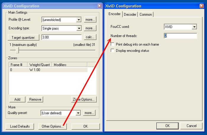

Go to the Xvid config dialog, press the Other Options button at the bottom, On the Encoder tab set Number of Threads to 2.
jagabo, I'm using Koepi's version 11.08.22, and I don't see that selection anywhere in 'Configure Encoder' when I access the program from the 'Start' menu.

Number of Threads is grayed out for me... It set at 0...

On my A64 X2 3800+, using VirtualDubMod to convert an MPEG file to Xvid in Fast Recompress mode, went from 78 seconds with 1 thread, to 56 seconds with 2. -
ah tnx... that version did it...

If you want the multiple threads then it needs to be a 1.2cvs build and the above build from Koepi is old. I'd suggest my most recent build instead.

The Nov 1 2006 release is a bug fix realease of version 1.1.x. It does not support multithreading. You need 1.2.x (still in "unstable relase" status) to use multithreading. The latest 1.2 I could find was the one I linked to earlier. celtic_druid says he has a later build but didn't supply a link.

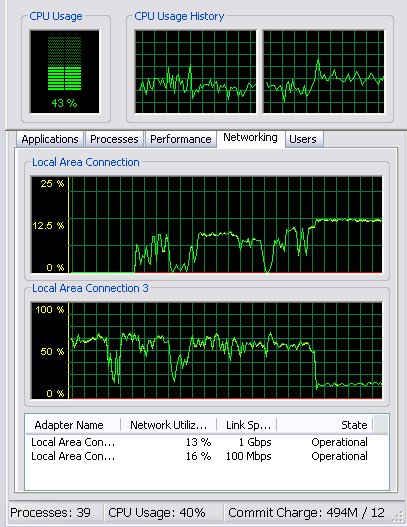

Xvid may not have the most efficient multithreading, but it does give exactly the same quality as when encoding as a single thread. x264 on the other hand uses slices, which require some overhead, meaning lesser quality per the same bitrate when compared to single threaded encoding. Anyway as per the above screenshot, Xvid works fine. ~95% of both cores in use here.
