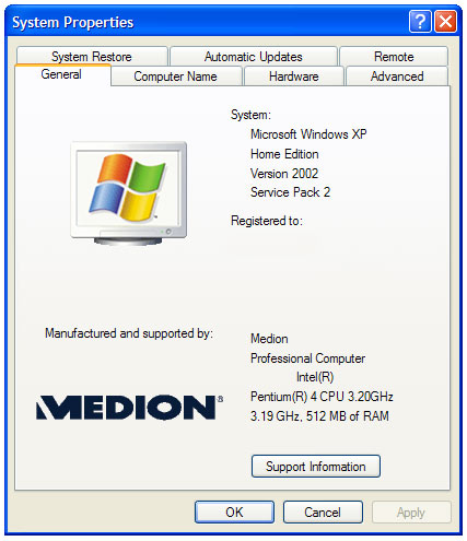

    SP2 refers to WinXP SP2 ... SP2 is just an update from Microsoft. If you constantly do Microsoft updates then you already should have WinXP SP2.
    You can check though by going to START in the bottom left corner and then go to CONTROL PANEL. Inside the CONTROL PANEL you have the option to be in CATEGORY VIEW or CLASSIC VIEW. Make sure you are in CLASSIC VIEW and you will see an icon called SYSTEM ... just doulbe click on that and you should see something like this:
    See where it says, "Service Pack 2"? Well SP2 is simply short for "Service Pack 2"
