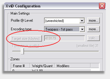

The output filesize looks like its being retained even when selecting 2pass-1st pass from the drop down list box before exiting the configuration dialogue. Its greyed out, but still entered correctly. When returning to change it to 2pass-2nd pass it is still retained, so I don't think it matters when the calculation is done, before the 1st pass or after it, the end results should be the same. Or it sure looks like it anyway.
