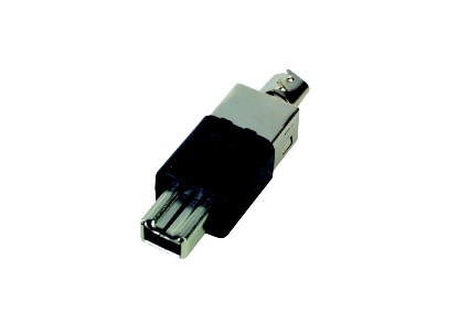

I guess I'm wrong - I must have a firewire cable instead of USB. The MovieBox came with a 4-pin to 6-pin cable. The little end has the squashed-in-the-middle plug that usually goes into a camera and plugs into this one at the DV port. The other end is the 6-pin end and I think that's the 1394 Firewire plug, so I guess this is strictly a firewire cable. The camera is a JVC model GR-DVL520. I'm trying to be careful - so please let me know before I do something stupid! I haven't tried plugging anything in yet. I'm confused on the software too - can I get a playable DVD using the Movie Maker program? I do want a playable DVD copy of the file on the cassette tape - not just a data backup on DVD. It sounds like I can plug this cable into the 4-pin plug on the camera and the 1394 port on the PC - and it should be automatically detected. Then I can use the Microsoft Movie Maker to copy the video to a DVD. Is that right?

Here's a pic of the end of a mini-DV cable, such as what plugs into a DV camera. The other end is usually a full-size, six pin FireWire plug.
If everything is working properly, your computer should detect when a FireWire device is plugged in and should recognize it as a DV camera. I would use WinDV or similar, though for DV transfers to the computer. -
Thanks for the pictures - those are exactly what I've got. If I use WinDV do I need the VirtualDub Mod also? The links are super - and I see that if I knew what to search for I could find a lot of this myself so I thank you all very much for your patience and assistance! When you know as little as I do it's hard to know where to start. It really helps to know what you use that works well for you instead of a huge list of options that I don't know how to choose between.
