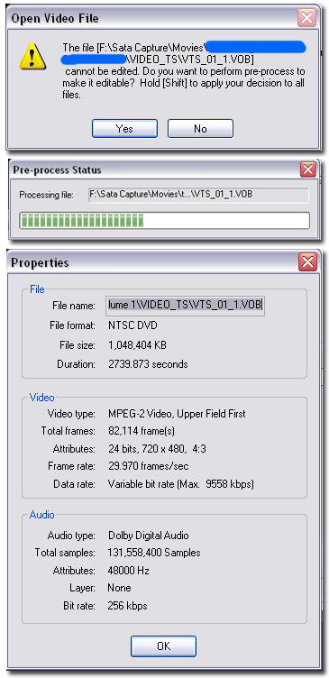

    When importing vob files in Ulead VideoStudio v10 the program has to preprocess the vob to make it editable (demultiplex). To make it easier to work on several vobs is why I say to do the preprocessing first then import the resulting mpgs. That means - use an external program (in my case I recommended VOB2MPG) to demultiplex the video and audio streams from the vobs, then multiplex them into system (video and audio) mpeg2 files. Then load those into Ulead for editing. Without doing the preprocessing first Ulead would then haft to process (demultiplex) each vob file everytime you loaded it. With so many dvds to work with - a time consuming task in itself.
    I don't know if V9 has this feature. To find out just start the program and go "Video" - browse to and try to load one of your vob files. Here is the response v10 gives me when I try to import a vob file (see attached photo). I click yes and the program demultiplexes the vob and loads it. Once loaded I can edit it as I wish.
    Preprocessing (demultiplex - multiplex) is very different than reencoding. Vob is a container and in your case it contains a video stream and an audio stream. Demultiplex copies out the two streams into individual component files. Multiplex simply combines these two components together again into a system file. This is not reencoding, simply a process to recreate your mpeg system files so you can then edit them or do whatever you want with them. Its simply a process to get them out of the vob container. A Hollywood vob file may contain several audio streams, subtitles, etc. Same thing as you have except for the number of individual components in the vob. Or something like that.
    I own Ulead VideoStudio V5, 6, 7, and 10. All my versions has Smart Render. After working so much in VirtualDub my brain now thinks of it as direct stream copy. Same thing. Ulead must be setup so you can get a smart render. To do that you simply make sure the project settings match exactly the video clip properties of the video you inserted onto the timeline (the project). As long as these two properties match then the program can use the smart render feature and do a direct stream copy. Which means= it will "not" reencode. That is good.
    The reason the program is setup like this is so we can put video of one type onto the timeline and export it in a completely different format if we wish. Say I have a movie in MPEG-2 thats 720x480 @ 9.8Mpbs and I want to create a VCD thats 352x240 @1.15Mbps MPEG-1. I simply set the project settings to my VCD specs, drag the video onto the timeline and hit export. In this case we desire direct stream copy to keep from loosing quality through a reencode process so we must take care to determine that ulead is indeed setup for that, by making the project properties match the video clip. This is easily done but is most easily done before you even start importing video. Open the program and go "File - Preferences" and put a check mark at the box labeled "Show message when inserting first video clip into the timeline". Apply this then drag in your first video clip. Ulead pops up a box asking if you want to set the project properties to match this first inserted clip - you answer "Yes". To make certain that Ulead is doing a smart render you simply watch the preview window when you are exporting your finished project. - . If the screen is either frozen on the first frame after a transition effect or only shows black or only shows moving video when it is encoding a transition or on screen text - then it is indeed using smart render. If you are watching your video project play in slow motion while you are exporting then Ulead is reencoding the video. Use the Escape key to stop the export and go back and determine where the project properties is off.
    Like I said above. I doubt if the video from all 7 of those DVD is encoded using the same settings. If you are going to take clip segments from all 7 of those to create your new video then Ulead will more than likely be encoding at least a portion of the video project. I would set the project properties to match the clip segments with the highest quality settings so they will smart render and reencode the segments with the lesser settings. You will need to determine the specs of all those files. Use Ulead - Properties and I use AVICodec alot to do this. The more you know the better plan you will have.
