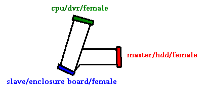

    Quick answer is to use software called PVRExplorer to capture the shows directly off your PVR hard drive using a USB to IDE connection, which also has guides on Yahoo. The PVR hard drive uses Unix, I believe, but the PVRExplorer software will recognize the drive, Windows won't.
    Problem is the video comes in a non-standard format, which I believe can be authored in it's native format and played on most current model DVD players. Once again, I believe there is a how to in one of the Yahoo groups.

    This is certainly possible. When I had Dish Network I used to copy the streams of the UFC PPV's I ordered. The quality was identical to the broadcast.
    The only pain in the ass about it was that I had to pull the HDD from the DVR everytime I wanted to do this. I drew up some plans for attaching a dual output from the HDD (one to the dvr m/b and one to an external usb board), but I never actually got around to doing it before I ditched Dish Network.
    Anyhow, to accomplish this, what I did was.
    Step 0) connect hdd to pc (either by usb or ide)
    Step 1) install ext2fds
    Step 2) start up dvr-dump to identify TS # you want
    Step 3) use dgindex to demux TS from hdd to m2v & mpa audio.
    Step 4) use ac3delay corrector to remove the delay from the mp2
    Step 5) patch the m2v file from 544x480 to 720x480 and to 3.5mbps
    Step 6) author to dvd
    It's a royal pain in the ass, but I imagine if you had the motivation to make the special setup for the DVR HDD so you didn't have to pull it every time it would probabaly be worthwhile.
  10. With a $20 USB to IDE convertor, you pull the IDE cable on the PVR motherboard and use a gender changer IDE cable to plug both the PVR hard drive (still in place) and the convertor to it. Only requires pulling the cover off the case. Plug in the USB connection, fire up PVRExplorer (free) and pull files off the PVR. I use this method. Works great. No conversion (quality loss) to go through, and it is light years faster than my old capture via ATI ALL IN WONDER setup (and much smaller MPEG files than I was capturing thru ATI card setup).

    If you want to go the IDE to usb route let me know and we can rig it up. It sounds like the capture card route really would take more time than it's worth. If you have 100 hours on the DVR then it will take you an additional 100 hours just to capture it. Then you'd still have to burn to dvd.
    Doing it the other way you could copy/convert/burn in much less time.
