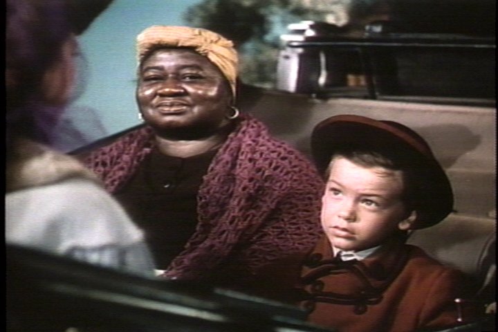

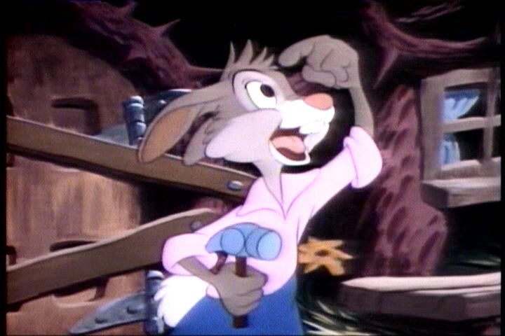

  14. I used a Sony PAL format VCR. I conneced it to my Hauppauge card via composite video. Then I used Virtual VCR and set it up for PAL capture. Then it was just like capturing NTSC, except of course it was 25 fps and 720x576.
    Darryl

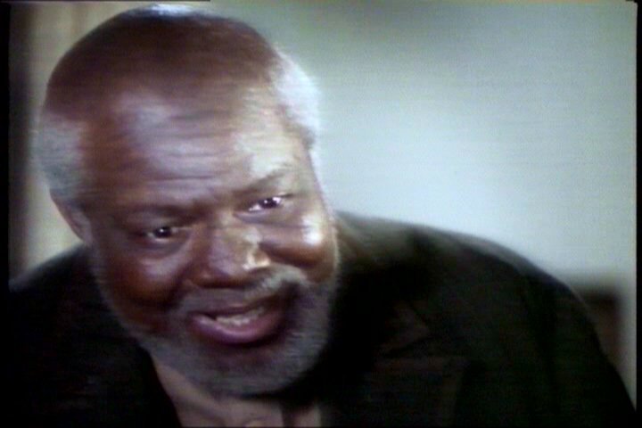

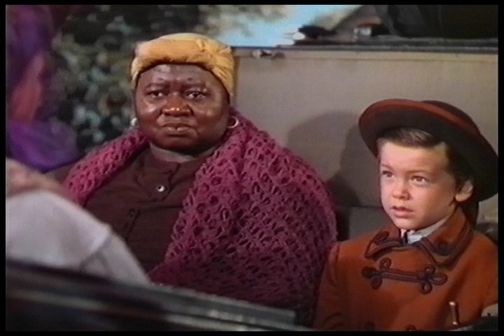

  15. Here are some captures from my home-made DVD (fro the PAL VHS).
    Darryl

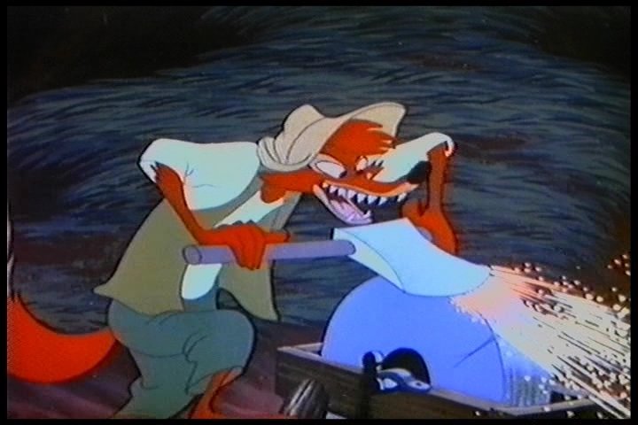

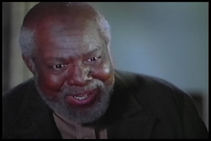

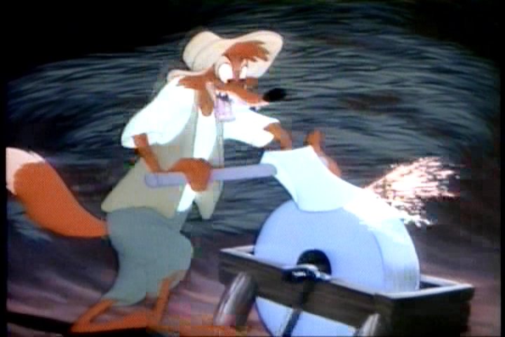

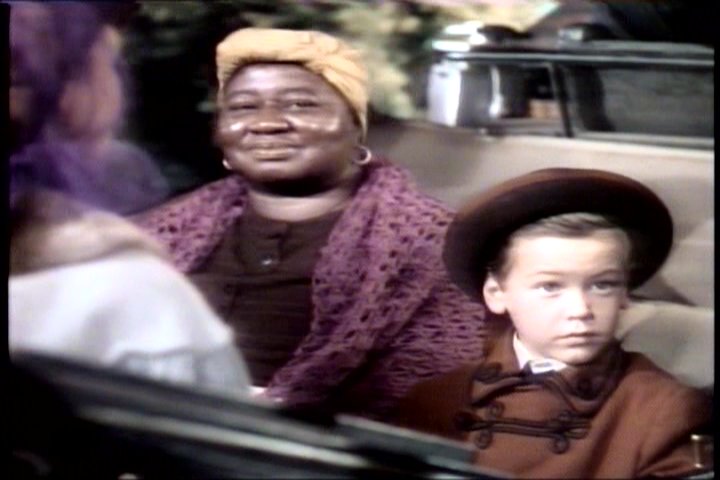

  17. Here are some caps from the bootleg:
    Darryl
  18. Hold on, I also have the Japanese LD. I got it after I made my DVD from the PAL VHS. I plan on making a new DVD when I get the time. The problem with the LD is that it has subtitles during the animated sequences, and some during the opening titles. But the picture is better than the Hong Kong LD (judging by what I have seen on this bootleg). The good thing about the Japanese LD is that it is telecined 3:2, instead of converted to PAL after the 3:2. In other words, it is reversible... meaning, I can get progressive frames from it.

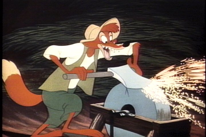

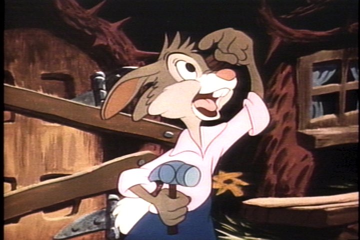

    Here are some screen caps from the Japanese LD:
    Now, I didn't spend a lot of time getting these quick captures from my LD. Perhaps it can be improved with better settings. But I think it gives a pretty good idea of what to expect. The big noticeable difference I see is better color on the VHS. But the LD is definitely sharper. But then again, you have Japanese subtitles every time somebody starts singing, and also over the opening titles.
    Darryl
