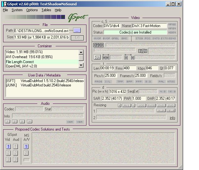

Here is the GSpot shot for source:
[Img]source.jpg[/Img]

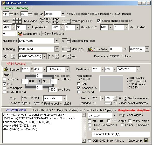

It was created by FitToDVD:
[Img]fittodisc.jpg[/Img]

What you have here is an over-compressed, relatively low resolution source, resized up to DD resolution and possibly over sharpened. What you are seeing are all the artifacts from all the pain this video has been put through.
Some things that anyone who is converting downloaded avi to DVD needs to consider
1. The gamma difference between PC and television is sufficient to expose a lot of flaws not visible when watching with your favourite media player
2. Most media players and many directshow filters have lots of trick built into them to improve the visual appearance of over compressed avi files during playback. These tricks are not in play when you encode.
I would suggest using a deblocker in your avisynth script before sharpening, and live with a little less detail if having more means enhancing flaws.Read my blog here.
Do I understand you right that it is impossible to impove the quality of the picture? Ot better to say, to improve within the reasonable effort?
You can make marginal improvements if you use a deblocking filter and do some noise removal. However most of the damage was done by compressing too much in the first instance.
If the numbers you have given are correct, you have an avi file with a resolution of 1016 x 432, compressed with the old Div3 format and a bitrate of 846 kbps.
Even "good quality" avi files compressed with Xvid or Divx would have a resolution of around 640 x 272 or even less at that bitrate. So your source file either has a resolution twice as large as it should be for the bitrate, or a bitrate one quarter what was required for the resolution. Either way, all the damage you are seeing was done during the initial compression. The data is lost, and you cannot get it back. The best you can hope for is to hide the worst of it with some clever filtering, and accept that it will always be damaged goods.Read my blog here.
