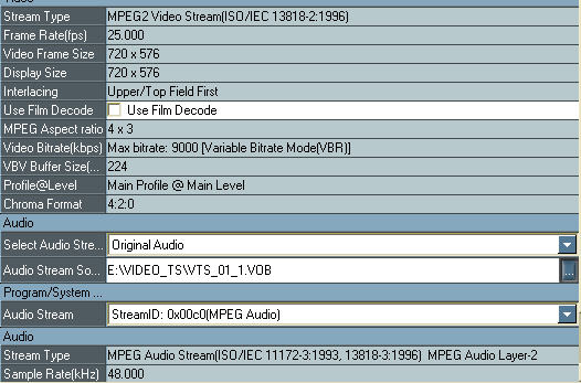

I imported a vob into procoder and this is what said 720x576,

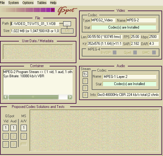

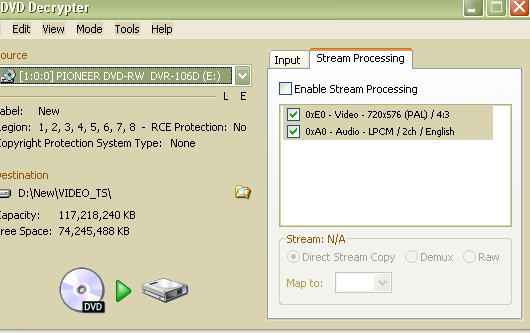

Thanks for your comments manomo, this is what i have found, looking at the first VOB in three different programs, two say it is 720x576 and one said 352x576, this is the readings, by the way it is this dvd that will not play sound on my standalone.
This is Procoders readout

This is DVD Decrypter

I said originally to open a vob in DGIndex to get the true frame size. GSpot is also good. I suspect the video headers have been patched, which might be why the other 2 say it's 720x576. Either that or they say anything PAL is 720x576. Anyway, I guess you're convinced by now it's really 352x576.
