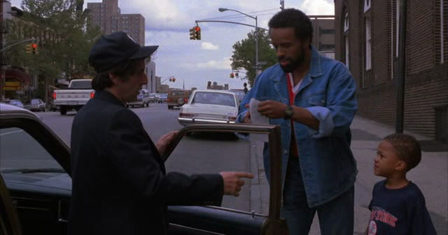

  14. I'm not sure what you mean by ghost removal, or how these ghosts got there in the first place. If this is something from a retail DVD, maybe you can upload a sample somewhere.

  19. I mean a picture where you can see like the second but clear silouette of a person or of a car or any other object.
    I know what a ghost/double image/blended frame is. I'm wondering how they got into the video in the first place. If from an AVI, then most likely the original encoder messed up. If from a DVD, then often upon reencoding, they can be fixed. For example, the RePAL filter can often fix the blended fields caused by bad PAL2NTSC conversions. Those things appear to be "ghosts" in the original DVD, but can be filtered out to a large degree when reencoded.
    And that's why I asked for a sample. I'm learning that making suggestions to you is a losing game, as we can only guess, based on your often misleading information (and I'm being kind here). This whole thread could have been 2 pages shorter had you posted those pics first thing.

  24. I'm not sure I see any ghosts. I do see a bit of Edge Enhancement (sometimes called halos). Is EE what you mean:

    I am not quite sure but it looks like it is not about EE.
    I realize it is hard to see on my pic. I am sure you've met it - the clear line running around the object. Sorry I do not know how to expalin better.
