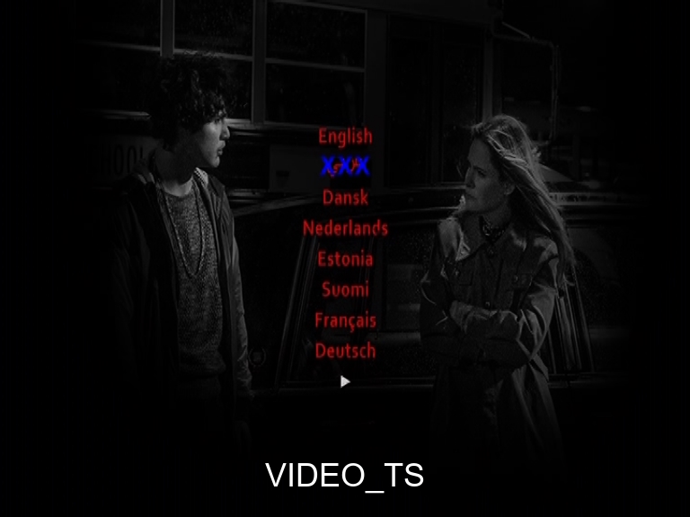

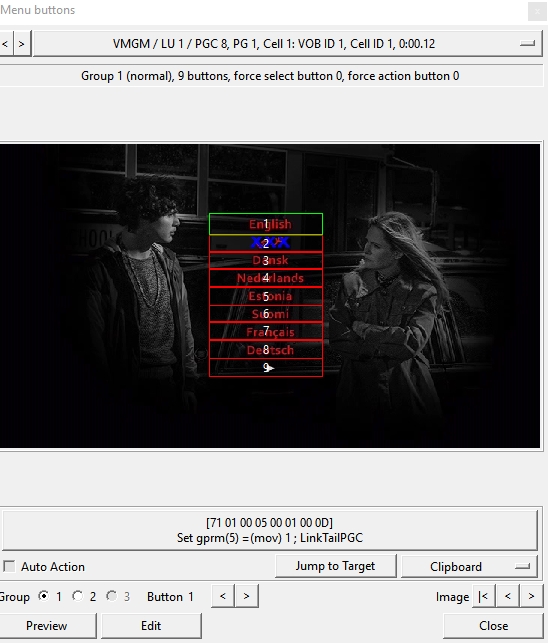

  29. In the last step of importing it seems to create the buttons
    [Attachment 59278 - Click to enlarge]
    but after I save, only the background menu appears, but without buttons
    [Attachment 59279 - Click to enlarge]

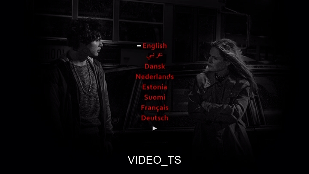

    This is the original menu where the white animation dash appears
    [Attachment 59280 - Click to enlarge]
    I only edited the .bmp file I didn't understand in the guide when you say "The motion menus are reencoded as any other video, best using a D2V project file and an AviSynth script, perhaps with overlays or subtitles to cover up, replace, and / or add text. "
    Sorry but I have very bad English, do I also have to use AviSynth?
    Where am I wrong? Can anyone help me?

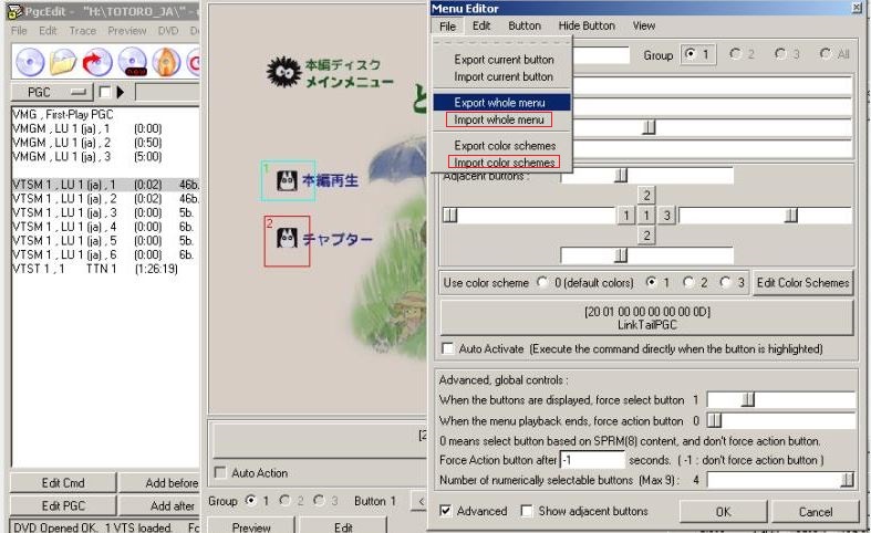

  30. at the beginning it was exported: Whole menu and color schemes (.mnu / .csm) ..
    6. Importing: .. now we have to import those two files to menu
    [Attachment 59281 - Click to enlarge]
