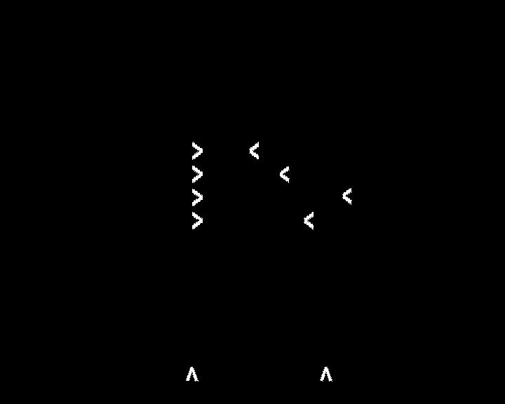

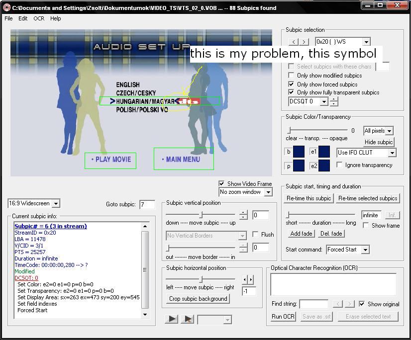

i've tried to edit the bmp in vob, but i couldn't. it is the pic:
i can't edit the symbol on the right side, only both at the same time and same way, but not separate.
Oh, then maybe I misunderstood you before. So you just want to change the "Hungarian/Magyar" to something else? Did you try and follow the guide, The Easy Way down at the bottom of the guide? Changing those letters to some other language name is pretty easy. Most picture editors can do it. Changing the underlying subpic could be hard. That's what I was referring to in my previous post. If you want to change it as well, you have to extract it from the DVD menu first, then edit it, then replace it.
If it's the > < part you want to change, I can only ask, "Why?". Maybe to change the distance they're apart after you changed the language name? That's the subpic BMP you have to extract and change. -
yes, manono, i followed your guide which is great! "the easy way" worked, because the first way the quality of the .bmp file has become very bad and blurred on some places. but at other time i managed to do it with demux and remux etc.
i can't how to extract the subpic in dvdsubedit. yes, you're right, i want to change the distance between the two <>, because i put a dts icon on the saved .bmp image, as i changed the hungarian audio from dd5.1 to dts, and it's simplier to put an 'original' image than a dts text in each text format, but the longness of the button has changed, too, as you can see it on th picture posted above. i made an .srt file, but can't add or change text.

finally, i have solved the problem, that i've erased the last symbol on dts icon..

If you need to change the shape or size of that green rectangle around "Hungarian/Magyar" in your first picture, or something similar in other DVDs, you do that in PGCEdit. Open the DVD. Highlight the menu (make it dark grey). Right-click that menu and hit "Menu Buttons". In the new "Menu Buttons" screen hit "Edit". In the new "Menu Editor" screen, adjust the size of the buttons. After finishing get back to the main screen, save your work, and test in a software DVD player before burning to disc. -
no, no, i can't extract it from dvdsubedit, and i can't add or change the text in it. i hace changed the bmp in pgcedit as you wrote and i put an a little pic on it, and i put it back with voblanker, but while i've been testing it i saw that the highlighted button, the last symbol hang into the part of the pic edited by me. i couldn't edit this part, so i've erased this symbol. but there are movies with highlighted text in menu that i would like to edit when i bring the mouse over it. but now i cannot do it. i ask for an advise to it.
i've changed the size of the button, but the place of the symbol hasn't changed. -
