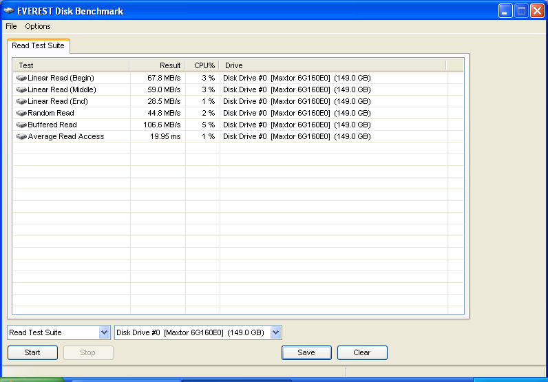

I used Everest Ultimate Edition to benchmark this SATA II and hear are the results:
Now,does this look like its working at a SATA speed?

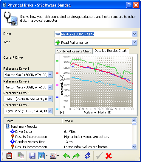

Don't be fooled by the ATA133 name, or even the SATA150. Those are peak optimum transfer rates and would be unlikely to ever occur in the real world. I have Sandra 2007 on my HTPC and I ran some speed tests a few minutes ago.
My Maxtor 160GB SATA300 hard drive and SATA2 controller:
Drive index: 50MB/s, Random Access Time 7ms.
A Maxtor SATA150 120GB hard drive from a SANDRA benchmark for comparison:
Drive index 29MB/s, RAT 14ms.
My Maxtor 80GB PATA100 Boot drive DMA6:
Drive index: 44MB/s, RAT 8ms.
A Hitachi PATA100 80GB hard drive from a SANDRA benchmark for comparison:
Drive index:29MB/s, RAT 12ms.
My computer was running a couple of programs at the time with some disc access, so that explains a little about the speeds. If nothing was running and the drives were empty and defragged, I might expect to see the SATA2 drive to get up closer to 65-70MB/s. -
More files on the tested partition slower it is. Empty is the fastest in test.

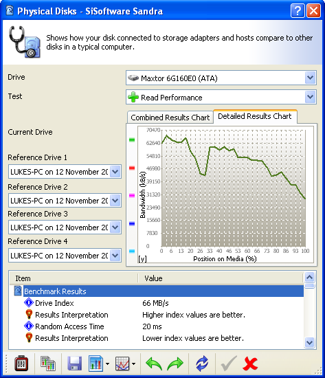

I have tested my HDD with Sandra 2007 to show my results.I take it these are good?
I will still most probably reinstall my old PATA just to compare.
Anyway here are the results.
~Luke~ -

I have had a reply from ECS and they say that the boot up screen shows ATA133 so that you dont need to install the SATA drivers at Window XP installation and its totally normal.I'm happy with their support,thats one good thing about them.They didn't comment on the Read Speeds or Random Access time I posted them so I'm not sure if the stats for my SATA are normal.The thing that concerns me is the Random Access Time.20ms is quite slow IMO.I've looked at Redwudz's RAT's and my SATA is slower than the PATA and I've tested my old PATA and the RAT is faster!
Another thing that is damn annoying is although I installed the SATA drivers off the installation disc that came with my motherboard the device manager still showed UDMA6 but I found that when I found the "Standard Dual Channel PCI IDE Controller" (I think that was the exact name) in Device Manager and clicked update drivers whilst the CD-ROM was in my DVD drive then my SATA would then appear as a SCSI HDD? Surely it should show as SATA not SCSI??? Anyway the hard drive now being "SCSI" makes NO difference in the read speed ect... so there is no point installing the stupid drivers.
I might buy a 160GB PATA because I'm running into stuff I dont understand and I really want to get on with my audio/video projects and also help people on this website without all this hassle.Maybe I'm just too fussy.

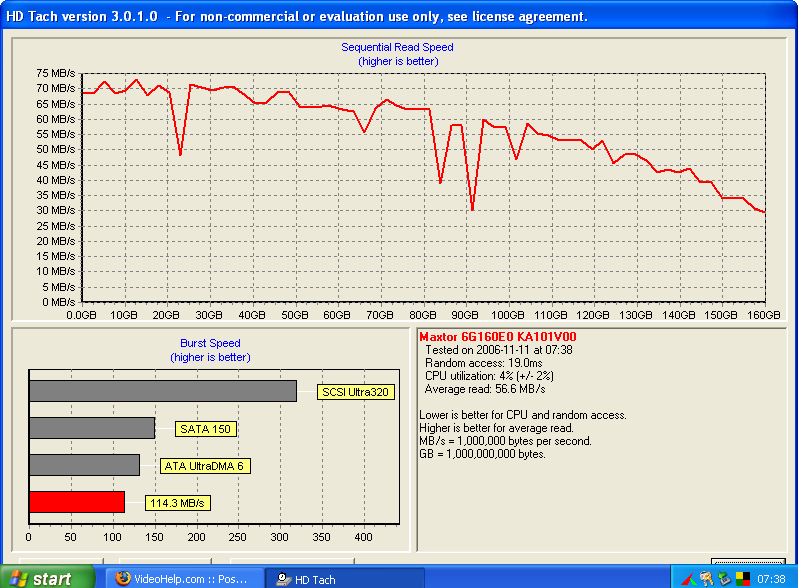

Here is the benchmark screenshot of my old PATA using SANDRA.Notice that the Random Access Time is faster!!!
~Luke~ -
laspis59, those benchmark programs are most useful for comparing speeds and bandwidth with very similar systems and to see if you have major problems. One difference may be that my benchmarked computer has SATA 2 controllers along with the SATA 2 drives, which seems to make some difference. My system is also running a 5% overclock of the CPU and memory.
I really don't worry much about hard drive speed and bandwidth as it has little effect on the overall speed or performance of the computer. That is more related to CPU speed and somewhat Front Side Bus speeds and memory speeds and bandwidth, and least of all is hard drive speed and bandwidth for overall system performance.
It's not uncommon that drives or controllers the system doesn't completely understand are labeled 'SCSI'. The unused RAID controller on my motherboard is called a 'SCSI/RAID Host controller', even though it has noting to do with the SCSI interface.
Some of the differences you see with drives may be related to the drive brand and model. It's difficult to compare two drives unless they are exactly the same model, on the same controller. But if your system is functioning properly, I wouldn't worry about much of this.
