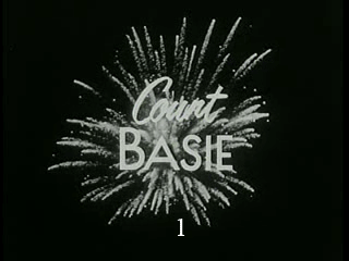

Here is a video:
ntsc.gifCann't tell it's possible don't tell anything. -

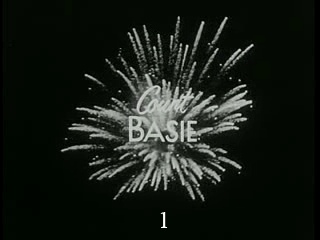

Ok, now I guess I did it. Just one word: Layer.
Usually there are many people ready to talk about everything else but the topic.
Clip0 = DirectShowSource("Rhythm And Blues Revue (1955) - [Count Basie, Lionel Hampton, Sarah Vaughan, Nat King Cole, Etc].m1v")
Clip1 = trim(Clip0,1,0)
Clip1 = SelectEvery(Clip1, 5, 1,2,3,4)
Clip2 = SelectEvery(Clip0, 5, 1,2,3,4)
Clip2 = trim(Clip2,1,0)
Layer(clip1, clip2, "add", 127)
assumefps(25)
Now, someone tell me it could be done better!
Here is a result:
