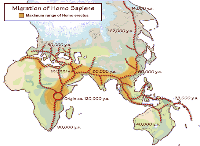

    I finally took the human migration file into Corel/JASC PSPro 7 and played with it. In this post I'm attaching the png version. It surprised me that since it has two layers that Vegas 6.0 accepted it. Further it looks like what I wanted. A bigger surprise is that I flattened it and put it into Vegas only to get a black ocean. I'll post it next.
    I guess one can only do these one at a time.

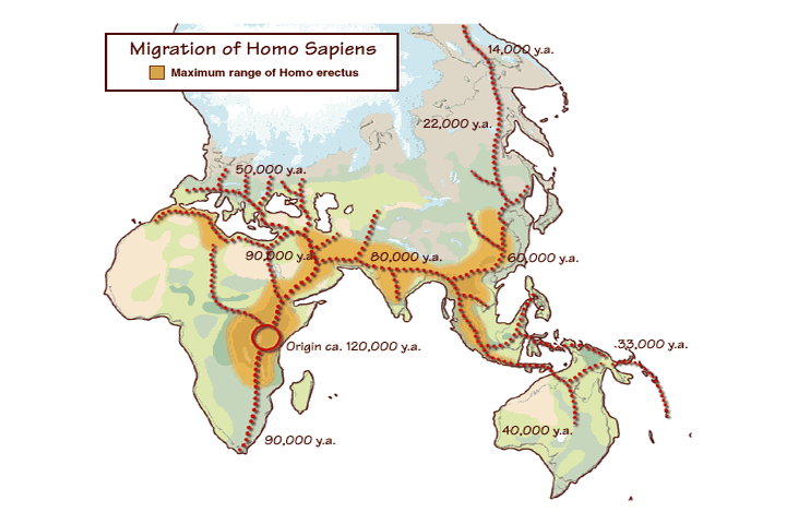

    Whoops, not black but the bare background. This one I produced from the other by flattening it with PSP 7. Not what I expected.
