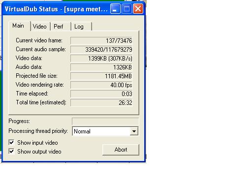

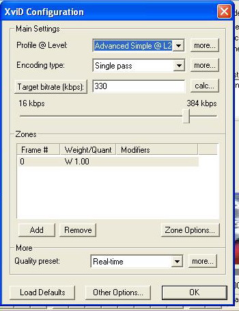

ok I uninstalled xvid then re-installed it. Still no luck. It's trying to make the file lager now.
I have included my settings and I'll post another image with the results. It's making the file 1200mb now. I even have it resizing the image to 360x240. Let me know what I need to do to change the setting. Should I be doing the "Samve as avi..." option under File?
Jeff

Don't use the Realtime profile. It doesn't use any (?) motion prediction and cannot achieve low bitrates. Move up to General Purpose.
330 kbps is pretty low for a CBR encoding of a 360x240 frame. You'll need twice that for a decent result. Unless you have a very still video or a low frame rate.
