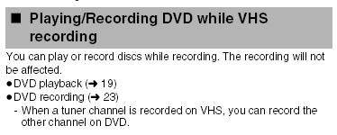

I was using a DMR-ES30V combo before the ES35V. The ES30V can do it, the ES35V cannot. See below from the ES30V manual,
Yeah, I don't know why on earth they would have gotten rid of that capability. Stupid move there Panny.
