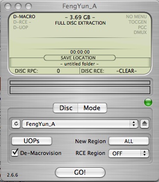

short version:
1. purchased dvd's from asia
2. live in United Stated. dvd player for tv purchased in US.
3. DVD player for tv wont play dvd's purchased in asia, plays fine on computers.
4. tried using MTR (mac the ripper) to remove the region settings. MTR shows: Disc RPC=0, Disc RCE= clear, New region=all
5. burned new dvd using toast 7, DVD-video from Video_TS
6. get same error message when attempting to play on dvd player for tv as i did with the original dvd purchased from asia.
7. according to disc info from dvd player on powerbook, video is NTSC format.
8. attached a image file of MTR after it reads the disk, hope it shows up.
Any ideas what going on? Am i not using MTR correctly? or am i screwing up somewhere else?
Ideas, suggestions greatly needed. thanks in advance.

You probably have a Matshita Drive which isn't region free which means in order to be able to play your burned DVDs in your set top you will have to change regions on your drive but be careful because you only have five total.

Yes, and he needs disks compatible with the drive.Originally Posted by lawnman
Maybe it only plays Region 1.
Worth a try to find out. -
