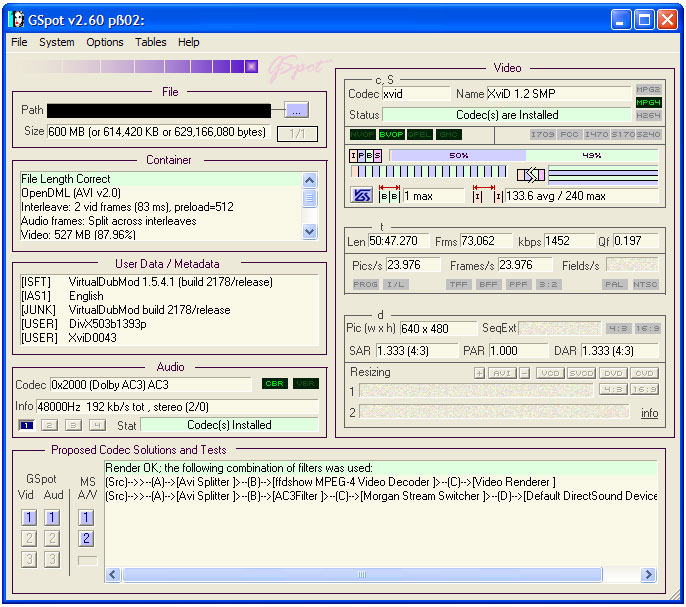

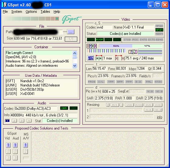

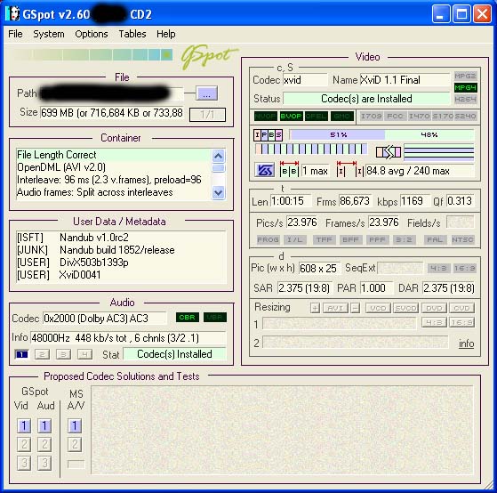

Open the AVI files with the latest version of GSpot then take a snapshot and post it here.
Follow my example:
For help on how to do this read the following link:
How do I upload screenshots ?
Once we know what we are dealing with we can then offer some help.
The audio appears to be 5.1 AC-3 (Dolby Digital Surround Sound) audio so I see no reason why the first file would be a different volume than the second file ... assuming this is one movie/program that was cut in half i.e., same single source.
Have you noticed this volume difference just playing back the original AVI files on the computer BEFORE any conversion or only AFTER conversion to DVD format?
Anyways with AC-3 audio I use VirtualDubMod to DEMUX the AC-3 audio. You may need to run AC3Fix on the AC-3 audio after doing that ... I know I always have to do that.
