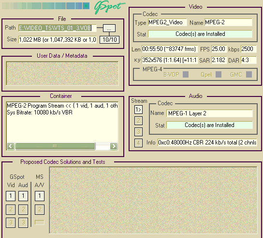

    Right, I lied, it does NOT play on all my standalones, it only plays on my Lite-on 5045 dvd recorder. I have taken a snapshot of the set up from gspot and here it is

  8. It seems OK except for one thing, the Container info says 1 video, 1 audio and 1 other. The bit about 1 other is not right and it should only say 1 video and 1 audio so it looks as though there is something in there that shouldn't be and it's probably that which is causing all the problems.
    Do you still have the mpg file you generated from the original disc? Can you run that through Gspot and see whether you still have the "1 other" shown?
