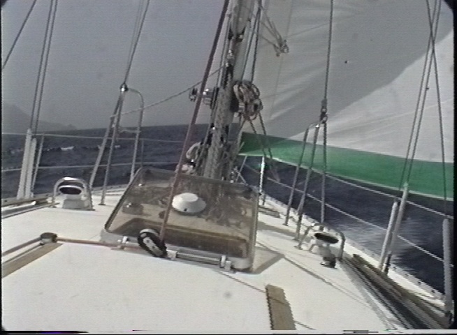

--camcorder is a sony digital 8 handy cam. Attached image is a frame being played in Media player classic.

It's normal. A combination of analog video head switching noise and viewing the full frame (normally hidden on standard TV equipment).
If your final destination is TV (e.g., via a DVD), ignore it.
If your final destination is PC, then mask/crop it.John Miller -
Maybe just bad tracking from the original camcorder. In TMPEGnc Plus, you can just select 'Clip frame' under the filter settings, if it's just a small amount of noise. You can add the bottom mask to pad the size back to the original.
From that screenshot, though, that would be in the overscan part of the video and not show on a TV anyway. I'm assuming you are talking about the very bottom of the frame. The interlace artifacts make it hard to see if there is any blurring or noise further up.

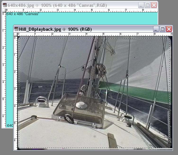

Yes it is normal for 8mm/Hi8, also VHS. Here is a typical Hi8 pass-through transfer to DV. The corner crops were caused by a lens hood. All this edge stuff falls into the overscan area of a TV. Even LCD/Plasma TV displays overscan at least 5%. You won't see it.
No need to crop if the target is a SD or HD TV. That is why they overscan in the first place.Originally Posted by zeek543

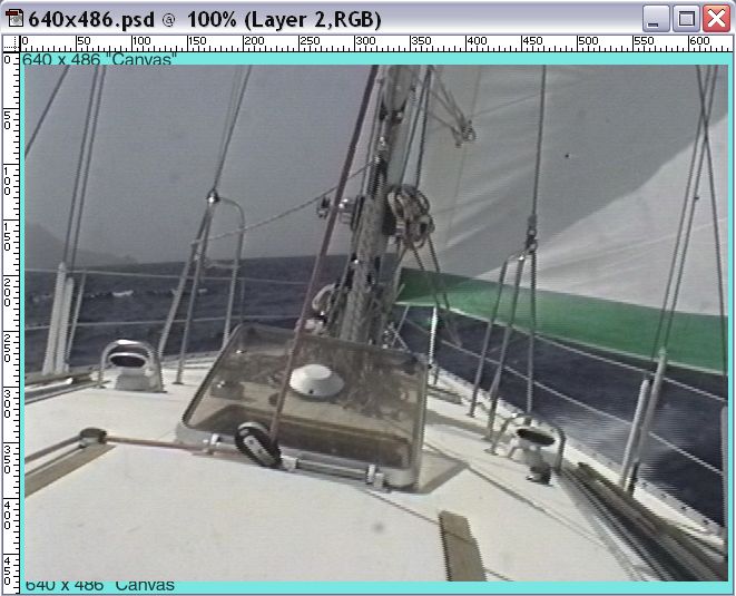

PS: There is mask, which puts black around the frame edge without resizing and there is crop which will scale the image (resize and degrade). Be careful.
Here is an example of a mask. The blue area would normally be black. Resizing usually blurs the image.
