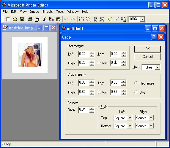

Install microsoft photo editor which is part of MS office.
use the image crop mat margins to add border. Like this :
