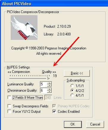

    Any compression will result in some loss. You will not notice this loss with huffy or with setting 19 in picvideo. The reason I suggest picvideo is because of it's higher compression ratio. I suspect the problem is not with processing power, but data transfer. So the higher the compression, the lower data transfer.

    I've just had a go with huffy and that was still resulting in dropped frames. However I've just tried PICVideo in the last 5 mins using PICVideo M-JPEG 3 VfW Codec for my first attempt and it resulted in only 1 dropped frame at the start which means I only need to capture a few seconds earlier than I would otherwise, so the actual footage I need is not affected. I need to capture in excess of 300 10-20 second clips so will give it a go and if it doesn't work out, I think I'll get a low cost pc to do the capturing.
    I see winifreid suggests setting 19. Which one is this as I can't see any numbers for settings.
    Thanks again.
  14. I'm using version 2.something but this might help:

    I've just tried the setting 19 and it seems like the computer can't keep up. I think the main problem is the drive so think I'll splash out on a 7200 laptop drive like this http://cgi.ebay.co.uk/ws/eBayISAPI.dll?ViewItem&ih=014&item=330044097982&rd=1&sspagena...MEWA%3AIT&rd=1

  17. You can verify that the problem is disk speed by using a lower quality setting in the mjpeg codec. Capturing at lower quality settings will take about the same amount of CPU power but the file size gets smaller and smaller as the quality goes down. If you can capture at 18 with no dropped frames then you'll probably be able to capture at 19 with a 30 percent faster drive.
