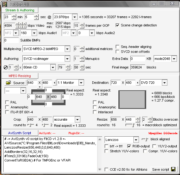

Either you haven't set it up correctly for 16:9, or it is 4:3 in a 16:9 frame, which is why you have the pillarbox effect. You should be able to do it in tmpgenc very easily, and if you search you will find the answer. I don't use tmpgenc, so I can't give you specifics, however you can also do the same thing with avisynth and FitCD, then encode with tmpgenc. Again, search the forums for FitCD, Overscan and/or Subtitles and you will find plenty of posts.
Read my blog here.
Take a look at my mini-guide to using FitCD ---> CLICK HERE
The nice thing about FitCD is that it has an option to account for TV OVERSCAN which is essential with fan subbed videos.

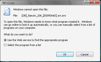

ok i made the filename.avi.avs with fitCD ran in in tmpgenc plus got error " the image is invalid what do i do i think im missing something.
Did you install AviSynth ?
The script seems OK although it's just text you didn't have to do an "image" of it.
My guess is you haven't installed AviSynth.
http://www.avisynth.org/

You just open the AVS file directly into your MPEG encoder ... treat it as if it were a video file.Originally Posted by miamiBoy\
There are a ton of guides on this site that cover all of this in extreme detail.
special thanks FulciLives and all others for the input when i open the avs in tmpgenc plus it gave me an error but when i opened it in tmpgenc express 3.0 worked like a charm after many coasters finally worked guess i need them for the football season anyway.
