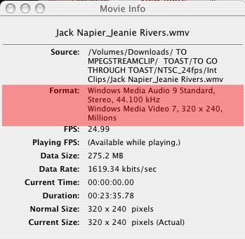

I use flip for mac to view on computer, but this thread is just about getting those files onto a DVD that works in DVD player.
LOOK at this:
http://img293.imageshack.us/my.php?image=picture4gp2.png
BTW:
what is difference beween .mov and .mpg (are they both Apple's quicktime method of viewing video?) -

The Second file, is using the WMA audio codec
and the WMV Image codec for video, which is
similar to Apple's Graphics codec. A real
generic codec good for graphics but not really
good for video.
Since you have flip4mac installed, export from
Quicktime Pro as a Quicktime .mov file,
choose AIFF for the audio, and choose Motion JPEG-A
for the Compressor, medium to high quality
(depending on what the movie looks like).
Set the size to half dvd ( 360x 240) and when
Toast goes to upscale it, the amount of data should fit onto
the DVD, with the other two files, at a runtime of 47mins.
