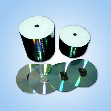

Can anyone tell me a brand and product name for inkjet DVDR media that doesn’t have red or purple dye recording surface, I want to achieve a pressed cd/dvd look, and yes, the color on the bottom counts! Can anyone suggest a product? And a retailer if possible? Please don’t post questions or dumb remarks about the color dye, to me it matters not to have red or purple. Thanks!![]()

Frankly, I have never heard of any German company that actually manufactures DVD-R media, and I can see no evidence whatsoever on Taiyo Yuden's site that they make any kind of DVD-R media with a silver data surface (as opposed to the silver labeling/printing surface, which they do make) -- so unless you can provide some kind of proof, via links to a manufacturer or distributor site that specifically mentions such products, both of your claims are somewhat suspect, I'm afraid.
As far as I know, what you want simply does not exist, and probably can't exist seeing as how DVD-R uses a visible-light laser and thus would need a dye layer which can absorb and reflect/be opaque to visible-wavelength light. They do make "diamond-surface" CD-R media, yes -- but that's only possible because CD-R uses an infrared laser, so the dye layer can be made to be (mostly) transparent to visible light while still being reflective to or absorptive of infrared wavelengths. (This is also the reason those black CD-Rs exist, while black DVD-Rs don't -- the "black" plastic is transparent to infrared, so the CD optics can still "see" right through it while your eyes can't.) -

The way CD/DVD Media is made is no big secret, and if you didn’t know, ill explain:
It is made with a plastic media polyurethane with a thin layer of a photochemical reactive compositions of carbon and minerals, such thing is the Dye, purple and red dye are made from organic molecules, that are photo sensitive, and it is a cheaper dye, the term True silver/diamond is a standard in CD industry, and it is accomplished by using a green dye on a silver contrast medium, therefore the CD/DVD ends up looking almost as silver as a pressed media…
In the other hand, when pressed media is made it is made just about the same as in the old days when vinyls were pressed, it’s a vinyl plastic medium with a laminated chrome carrier… and that is the reason it looks silver / pewter color…
In my case, I give my friends and clients a DVD from wedding or get together and of course I am not going to do mass production…2 years ago I bought 5thousand units of a German made DVD media, because that was at wholesale price and minimum quantity of sale, so it lasted me a long time, the media I had was white printable inkjet media with true silver / diamond surface, a little greenish but almost as good as silver… the reason to prefer this other than purple dye media is because it lasts longer, it doesn’t get much UV damage and it looks great…besides it is a flawless media.
Most importantly, if you read closely, I wasn’t asking for someone to tell me what is obvious, all I needed was someone who knows where to buy “yuden” ( Chinese brand) media of this type, or any other brand… IT EXISTS, EVEN IF YOU DON’T KNOW ABOUT IT don’t bother to insist it doesn’t help much if you do.

If all you want to do is get more disks like the ones you had before, just put one of them in a drive and use ImgBurn (or other programs) to get the media id. It doesn't matter whether it has already been burned or not. Once you have the media id, google should be able to help you locate more of them.
To be honest, I also don't think what you are looking for exists, and I'll tell you why. While dvd duplication houses will bend over backwards to fulfill requests (for an added fee), they don't offer "silver bottoms" as an option (no matter how much you are willing to spend for them). Given the demand, and potential profit, they would have long ago rooted out such media if it existed. There are also pages like this one that explain why media distributors can't fulfill requests for "silver bottom" recordable disks. Once again, despite the large demand, and the loss of potential profit by not meeting the demand, the unavailability of the product prevents the welcome business.
By the way, the outer layers of dvds (stamped or recordable) are made of polycarbonate, not polyurethane or vinyl. Also, aluminum is most commonly used for the foil layer in stamped dvds because it's inexpensive and relatively impervious to corrosion. I've also heard of gold, silver, or copper being used, but not chrome.
