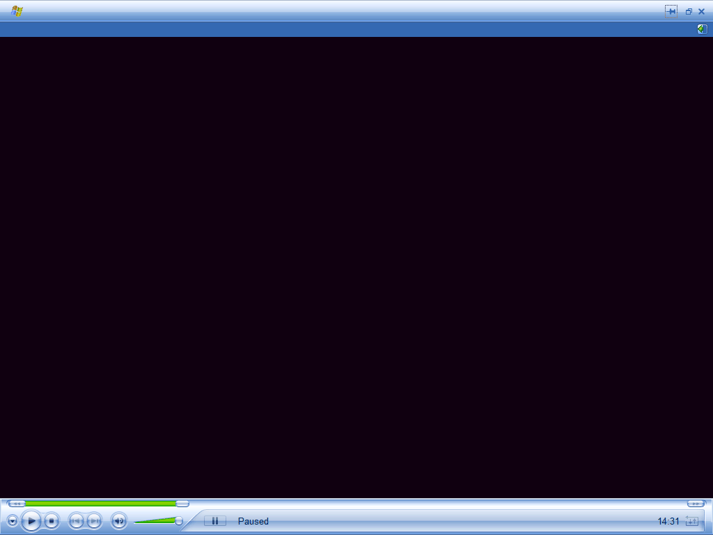

    The best VCD encoding that I've done to date was using a DVD master, then encoding with VCD easy - about two or three years back. Most of the others that were burned with the old Teraping unit five years ago are at best VHS quality, even using a DVD source. I've included a screen capture on The Green Mile that was encoded to VCD.
    BTW: If I remember correctly, it took several hours of encoding to produce the three discs; more than encoding a DVD with Rebuilder at mastering quality.
