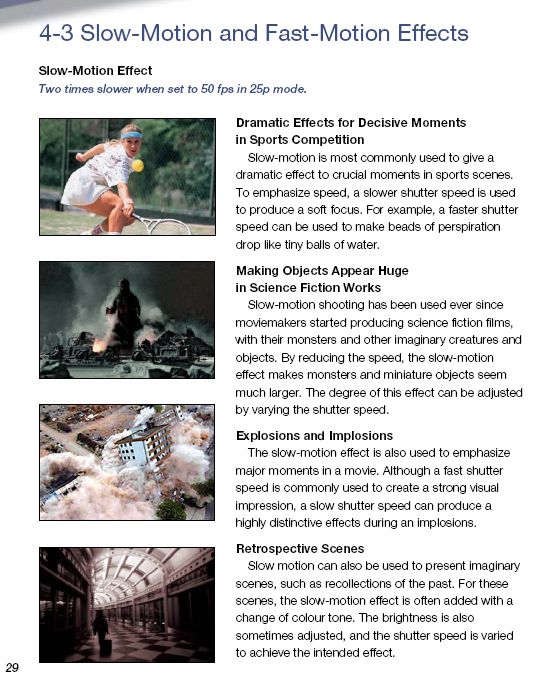

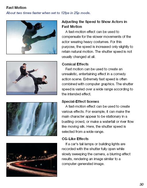

Check out pages 29 and 30 of the AGHVX200E_GuideBook for typical Varicam effects.Originally Posted by pijetro
