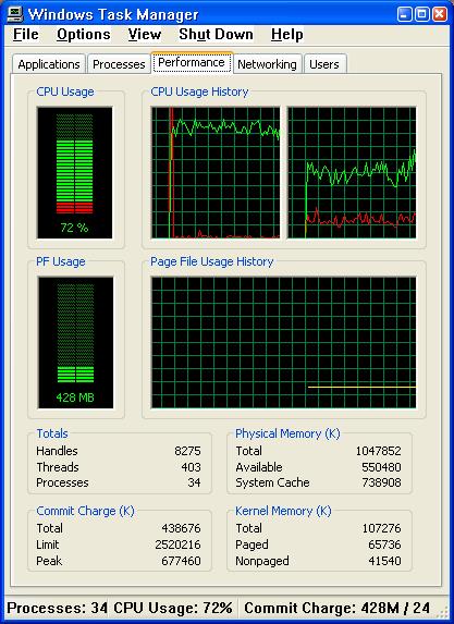

  10. Originally Posted by Z-C
    Since my cpu never reaches 100% usage on encoding(it's usually somewhere between 40-80%), I was thinking that the HD is the limiting factor
    What CPU do you have? 40 percent is very low. On a single core CPU you should always see nearly 100 percent. On a dual core CPU it will vary from 50 to 100 percent depending on how well the code is multithreaded. For example, on my Core 2 Duo system TMPGEnc Plus usually runs at 100 percent, VirtualDUbMod with Xvid around 70 percent, CCE around 80 percent.
    Here's an AVISynth/VirtualDubMod/Lame/Xvid encode:

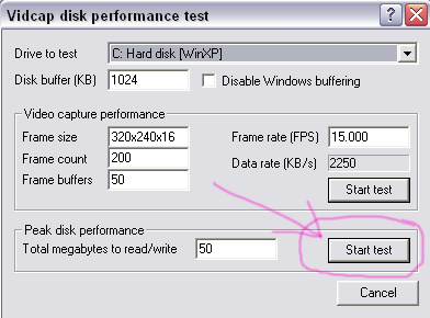

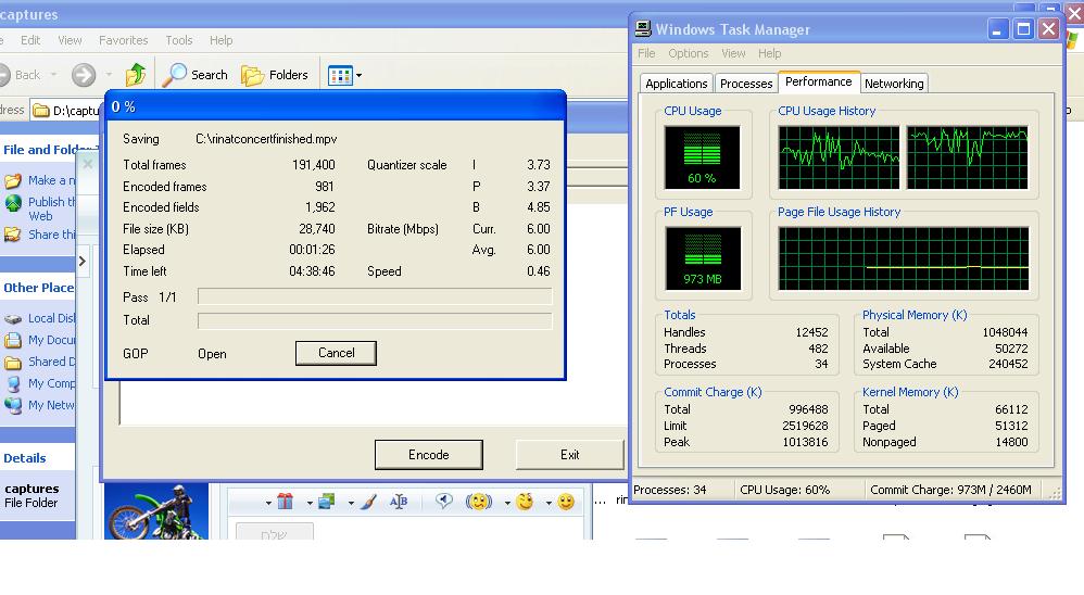

  22. Originally Posted by jagabo
    I played with the decoders settings and was able to 'maximize' the cpu usage to 70% avg. it now varies from 50%-90%.
    By the way - I just wanted to say that I didn't have the time to check back in yesterday, and I'm amazed to see the interesting discussion that developed here.
    If it matters, I was convinced to neglect the idea of RAID0, due to this thread.
