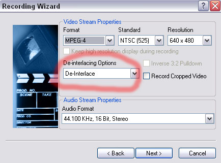

    In one of my posts above I edited the ATI MMC Home Theater MPEG4 preset. Here is a screenshot of the preset. As you can see ATI has set it to deinterlace. So if he is right and OpenDivx v4 can't handle interlaced video then when using the defult ATI preset it is not interlaced, its encoding a deinterlaced source. Right?
    I guess I would just like an explination of what Fugi is talking about, since I have been completely unable to find any answers in all my searching on the web since that day. What is it about MPEG4 that makes it so crazy to try and capture video with it, even when the captured video looks so good? What in the world am I missing here..... Someone please explain this. ok.

    I never looked at Divx's deinterlacing so I ran a few quick tests. I assumed they would do something simple like dropping one field or blending the two fields together. I was surprised to see they are doing some sort of smart deinterlacing. Similar to a kernel deinterlace with AVISynth at first glance. I didn't test the deinterlacing speed though. It may not be suitable for real time encoding. In any case, the OP is capturing at 320x240 so the capture card is deinterlacing, the codec doesn't need to.
