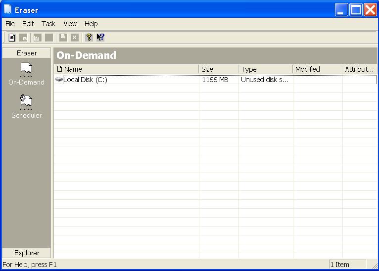

    Okay, I installed eraser, but I am not sure if I got everything correct. It only shows how much unused data I have on drive c, but it doesn't show any details:

    What did you choose to erase ?
    If you want to cleanup old deleted files, choose Unused Space on Drive.

    Did you see this screenshot above? Thats what is says, but when I was observing the process I was concern that eraser is doing to much.
    I'm going to try this on a hard drive that I was going to reformat anyway and I'll do some experiments.

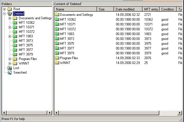

    Okay, I finished testing and here are results:
    PC INSPECTOR FILE RECOVERY before errasing

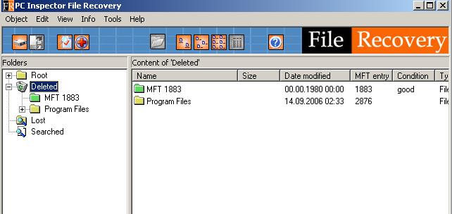

    After errasing

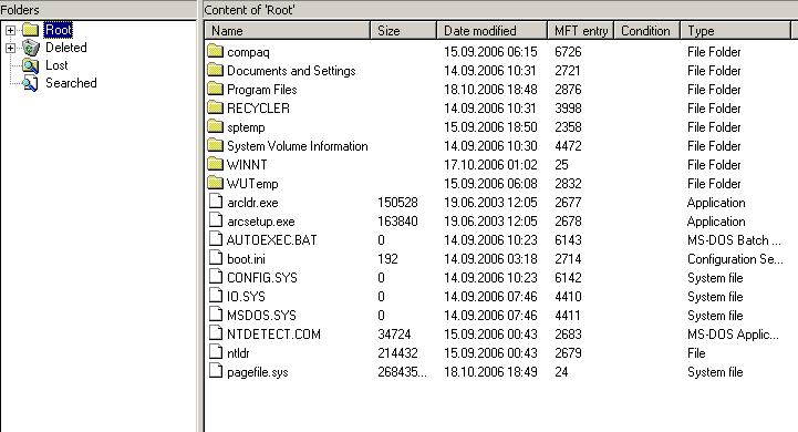

    Screen shot from ROOT before errasing.

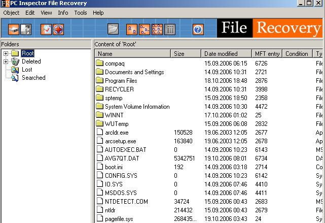

    After errasing

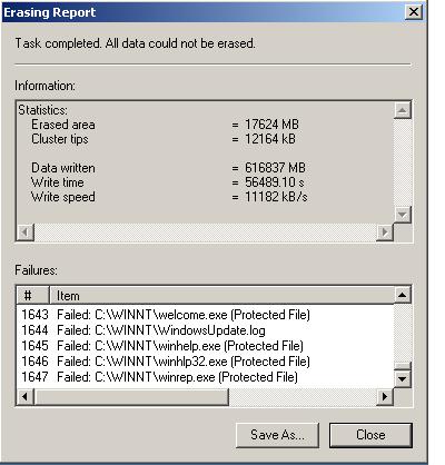

    And finally errasing report that shows lots of files that hasn't been errased (mostly windows protected files)
