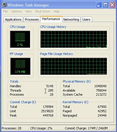

    Just out of curiosity, when you first bootup, how much free ram do you have?
    ctr-alt-del, select performance tab

    Here is my performance upon startup. yet now, about 5 mins after first starting up. the CPU usage has gone down significantly and isn't doing the big jumps...

    Looks like you have plenty of ram available (600+ megs), but you show high cpu usage so you must have a lot of stuff loaded into memory and running. If you notice (the system graphic) we both have 1 gigabyte of ram, but I have a lot more available than you. You have a lot more processes running. The drop in cpu usage after 5 minutes from startup probably means you have a bunch of programs like windows update, antivirus etc ..trying to automatically update themselves, running up your cpu usage.
