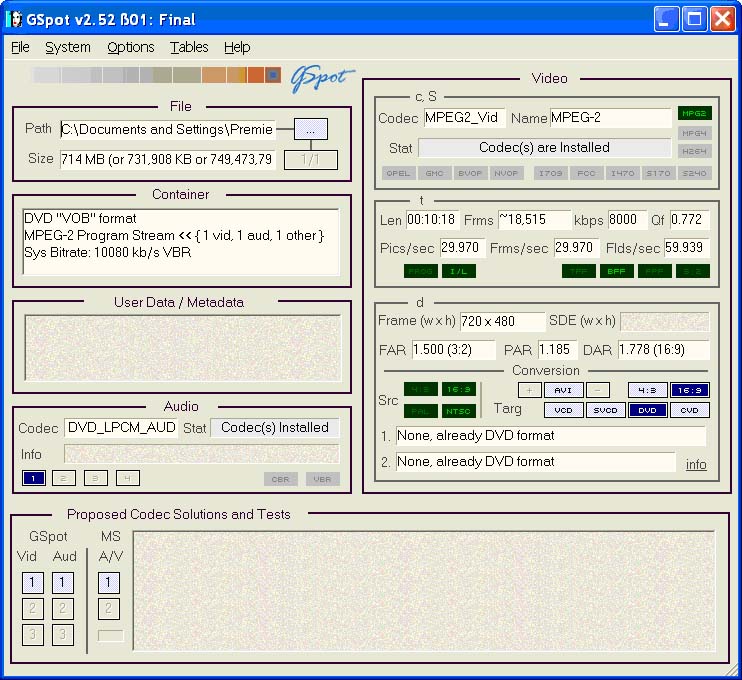

I am using Verbatim “16X certified” DVD-R disks. I am burning at 4X speed. I used a constant bit rate of 8,000 when I encoded my file with MPEG Encoder. I am using ver 2.1 of ImgeBurn with a file system of ISO9660 + UDF. Below is a screen shot of the file that I used to create my vob files with DVD Author 2.0
I went out and picked up some HP DVD+R disks and burned 4 more DVD’s using both ImgBurn and Roxio and I none of them worked. Is it possible that messed something up when I encoded my AVI file using MPEG Encoder? In my above post, I attached a screen print from G Spot of the MPEG file I am using. Any help would be appreciated.
Sorry, I'm not seeing anything wrong in your Gspot post. Unless I am missing something, it looks fine.
You have a widescreen MPEG-2 video file. LPCM takes up a lot of audio DVD space compared to AC3 or MPEG 1, layer 2 audio, but it is compliant with the NTSC DVD standard.
The only conclusion I can come to is your player(s) at fault or there is a problem with your burner. This is if you are absolutely sure that the media you are using works perfectly with your burner and your players. It's not really likely that this is a software problem with your burning or encoding software.
