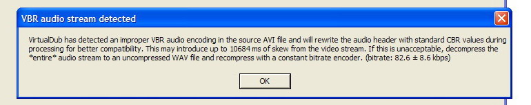

    I was able to download an older ver of Virtualdub. Here is the err window when I opened the AVI file.
    Percy
  28. Член BJ_M's Avatar
    Jul 2002
    Canada
