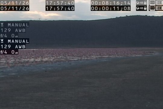

    Here's an example. The source tape was captured/transferred via Firewire from a Sony DV camcorder to a hard drive on a Windows XP PC. I used our Enosoft DV Processor since it lets you burn the time, date, timecode etc during the capture/transfer. The DV file now on disk was then sent to another DV device (in this case a Sony DSR-11 tape deck) via Firewire using the same Enosoft DV Processor. Finally, I then captured/transferred from the DSR-11 to the computer, again with the DV Processor software. What you see in the image is that the date and the time of the recording (and the camera settings) remain unchanged - only the timecode changes.
    Date = 05/11/26 = 26 November 2005
    Time = 17:57:40 = 5:57pm
    Timecode (original recording): 00:08:16;14
    Timecode (copied version): 00:00:11;08
    Note: It isn't necessary to use the Enosoft DV Processor for the capture/transfer.
