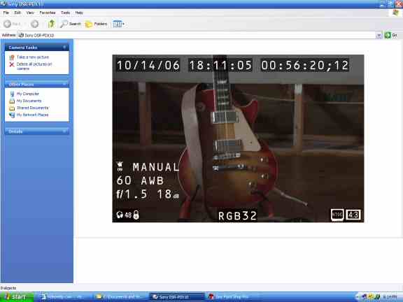

A live feed from a DV camcorder (at least the ones I have tested) will have the current time, date and camera settings (white balance, gain etc). If there is a tape in the device, you will also get the timecode of the position that the tape is at even if it isn't recording. Attached is a screenshot from a live feed. The camcorder is in camera mode and connected to a Windows XP PC via Firewire. Our Enosoft Enhanced DV Decoder is installed.Originally Posted by ZAPPER
John Miller -
Then you should have no problem just copying from one camcorder to the other via Firewire. Only the timecode will change.Originally Posted by zoranbJohn Miller
