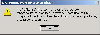

thats right, at least thats what nero is telling me.HELL AINT A BAD PLACE TO BE -
yes, nero 6 v 6.6.0.15
i didnt change anything on the default configuration.
here is a screenshot of the nero message :
the same message appears when it comes to a big avi file,
again - i can handle the avi problem by creating an iso image
and burning the image, that works out fine.
but what can i do about the mdf file ? i need it AS A FILE on a dvd-r
and if i burn it using DVD-UDF it doesnt work on my other computer.
should i really just stick the mdf inside an iso image and burn it?
or is there a better way to do it?HELL AINT A BAD PLACE TO BE -
If you burnt it in UDF (v1.02) with Nero, it should be readable on you other computer (assuming it's recent--Win2k or XP). If it isn't, that's the fault of the computer (or you could just have some bad media).
For files that large, you should be burning UDF only.
